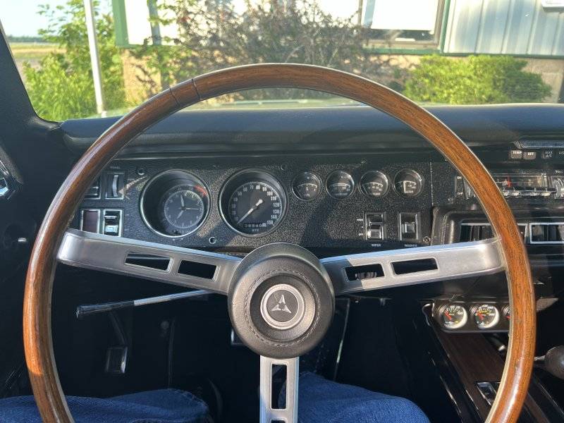

1969 Charger. I’ve searched and searched but can’t seem to find any reference to my exact issue. Ammeter seems to work perfectly but gauge is always negative. This is a picture of the ammeter with the key off. If I open the door or turn on the headlights it shows a draw to the left as it should. When the car is running, the ammeter is in this exact same position and again shows a draw if I turn on a blinker or headlights (only briefly and then returns to this same state of negative gauge indication).
Is there a way to get this gauge calibrated or adjusted to show zero in the resting state? (I.e. key off). This is an aftermarket ammeter and not the original.

Well, to wrap up this thread, the ammeter showed a negative (discharge) even when the battery was disconnected. I got into the rally dash and tweaked the needle to center with no battery connected. Once battery was reconnected, everything looks great. Stays center except when there truly is a draw. Slight positive when charging. Thanks everyone.
