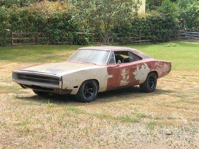

I'm rebuilding the original engine in this car:
It is a 383 2 barrel. It is virgin bore with original pistons, steel crank, 727 trans and 3,23 gears. I have other ratios I can use including 3.55s and 3.91s. I put a 3.23 chunk in it just because I had it handy.
I will be using 1 7/8" headers, a Holley 750 vacuum secondary carb on either a Holley Street Dominator or an Edelbrock Performer RPM intake. At first I might get it running with a points distributor or a stock based electronic ignition.
I am looking to be at or below 9.5 to 1 since I am using iron heads with stock valve sizes. I have a set of '346 heads that had been rebuilt with new exhaust seats put in. I did some amateur porting to them and have them at the machine shop now for a 3 angle valve job.
