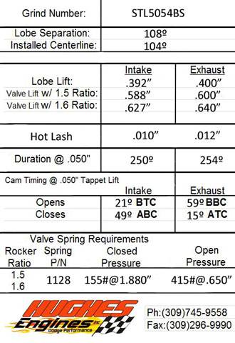

So.. Narrowed it down to these two cams.
Trying to calc the dynamic compression but the ivc for the lunati is speced at 0.02 lift and the Hughes at 0.05 lift.
Lunati 30230742:
[email protected]: 251/259
Lift. 566/.586
Lsa/icl: 110/106
Ivc @.020: 52 deg
Hughes stl4650bs:
[email protected]: 246/250
Lift:. 576/588
Lsa/icl: 108/104
Ivc @.050: 47 deg
Im at 10.3 static comp
I've calculated the Hughes cam to be at 8.3 dynamic comp.
Can anyone help me calculate the Lunati please.
Thanks

Wallace racing calculator says 8.9 dynamic using 52 degrees IVC.
That must be wrong, rhe wallace calculator requires seat to seat specs.
I only have 0.05 and 0.02 specs
It does require seat to seat. I used the .020 figure. Using Lunatis advertised duration of 280/288 it gives an IVC of 66 degrees. Putting that in Wallace gives an 8.09 DCR.

The Hughes cam is ground by Howard’s.
Howard’s shows that [email protected] lobe to have an adv duration of 274....... but they don’t specify at what lift figure that’s at.
It’s probably .020, but I can’t say for sure.
Due to the covid situation, there has not been any racing.
However, I finally ordered a camshaft, I think will perform pretty good.
Howards cams, if the valve to piston clearance allows, I will use 1.6 rockers for a lift of 0.6
Year:
 1959 - 1980
Make:
 Chrysler
Engine:
 383-440
Camshaft Type:
 Mechanical Flat Tappet
Basic RPM Range:
 2500 to 5800
Valve Lift Intake:
 .576
Valve Lift Exhaust:
 .576
Duration Intake:
 274
Duration Exhaust:
 274
Duration at 050 Intake:
 246
Duration at 050 Exhaust:
 246
Lobe Separation:
 108
Intake Centerline:
 104
Firing Order:
 1-8-4-3-6-5-7-2

Update,
Well, pretty much impossible to get a cam these days.
I found a swedish company that had a cam on the shelf, so I pulled the trigger
