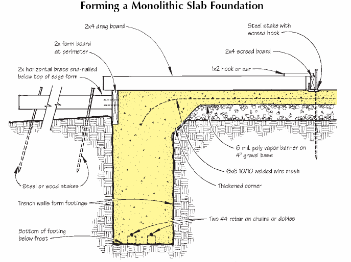

This one has me interested, a bit more concrete but the truck rolls in and pours it... Done!
This is what I've seen as a "garage foundation"??? Just doesn't seam right being that shallow??? An insulated 36" deep footer I would think would keep more cold from getting under the floor?
So my real question and reason for this thread is, what do you think of the footer and floor being poured as 1? Would the floor be prone to crack along the footer? Never saw it done like this but would think doing it like in the first pic where the floor could float would be better?

concrete shrinks so yes it will crack if poured all together
pour footings and frost walls then the floor so the are not attached and the floor can shrink with out cracking
