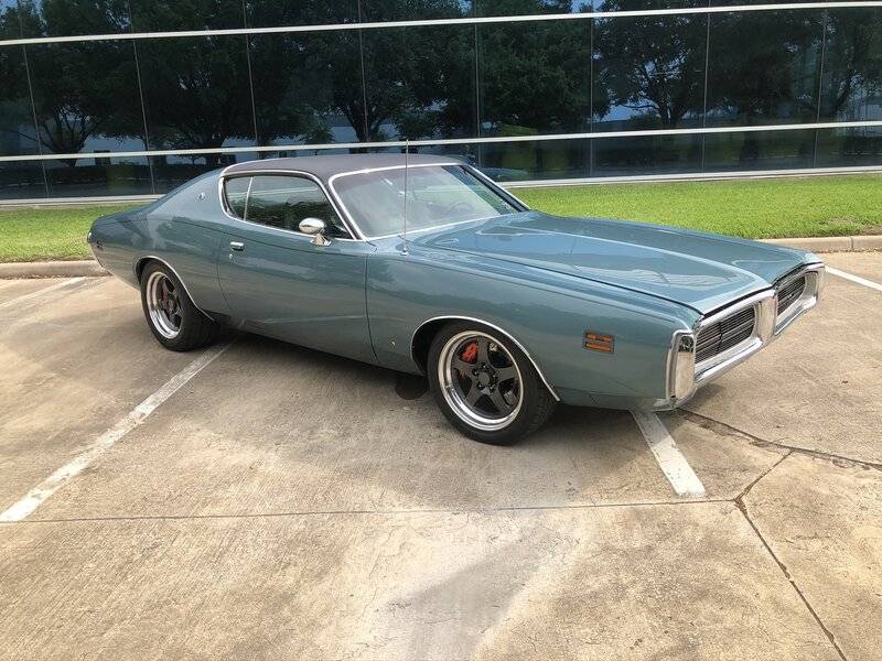

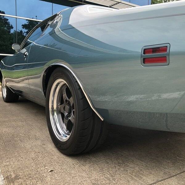

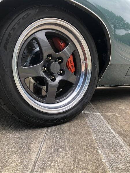

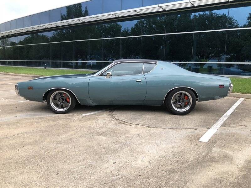

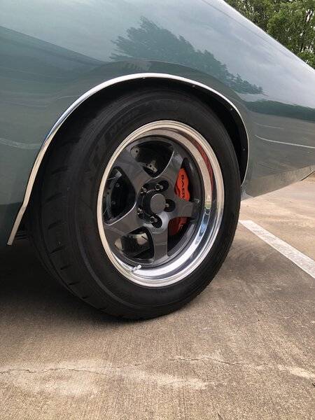

71 Charger SE. No wheelwell or leaf spring modifications. Wheel centers painted Porsche Agate Grey Metallic. Passenger rear rubs on occasion. It would not, if rear end was moved just a 3/8" or even less to driver side
Nitto NT555 245/45/18 on 18x8 Fiske FM5, 4.375" backspace
Nitto NT05 295/45/18 on 18 x 9.5 Fiske FM5, 5.375" backspace
View attachment 1082237 View attachment 1082239 View attachment 1082240 View attachment 1082241 View attachment 1082244
Hey Daniel- I have a 72 charger, what Brakes do you have? I can't tell from the pictures.

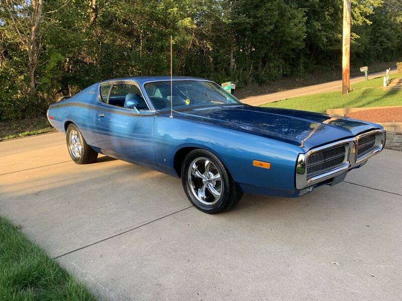

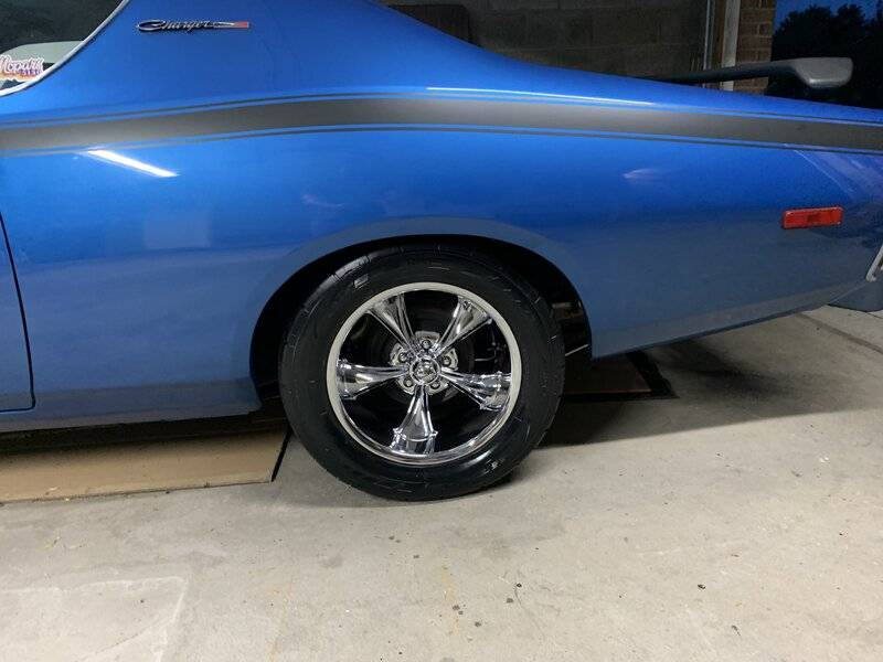

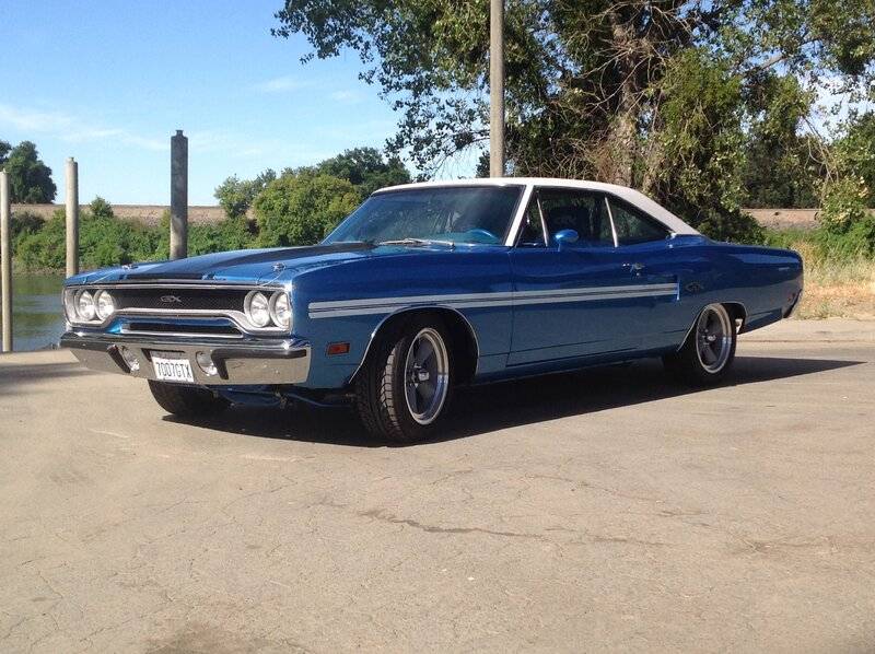

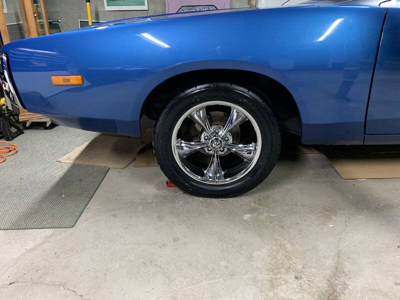

I know its not 18 or greater, but I went with Ridler Rims 17x7 front and 17x8 rear.
Nitto NT555 G2 255/50ZR17 in Front 275/50ZR17 Rear.
I previously had 235/70R14 front and 235/70R15 Rear on old Cragars.
The profile difference were almost identical about a half inch, so I did not have to do any modifications.
I need new pictures, because I put new leaf springs on after these were taken, so the stance has changed.

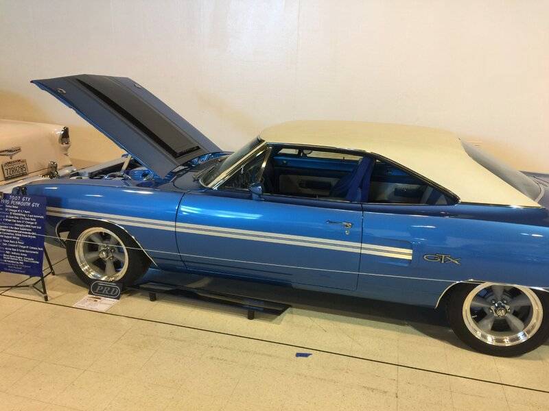

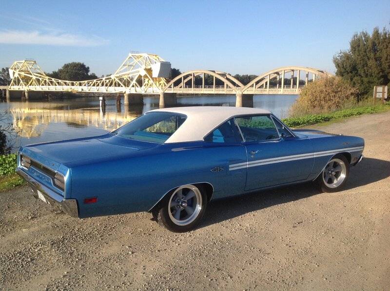

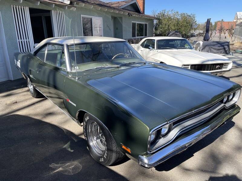

It is a vinyl roof. Don't know about your paint job, maybe someone didn't like vinyl.They are notorious for causing rust due to trapped moisture.
Can you please post more pics of your car
Not yet but it IS for sale.$90k because I KNOW that will be your next question.

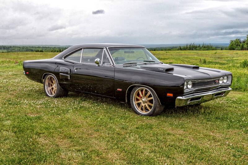

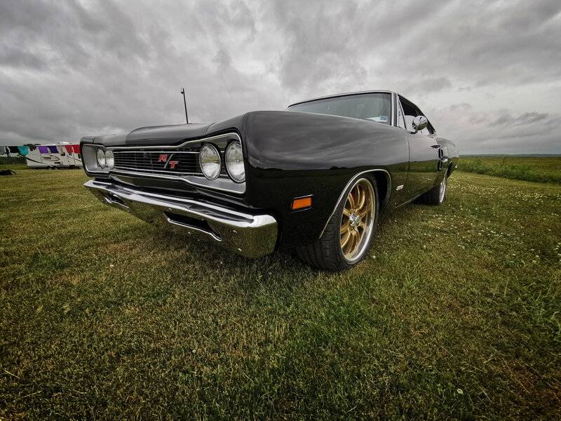

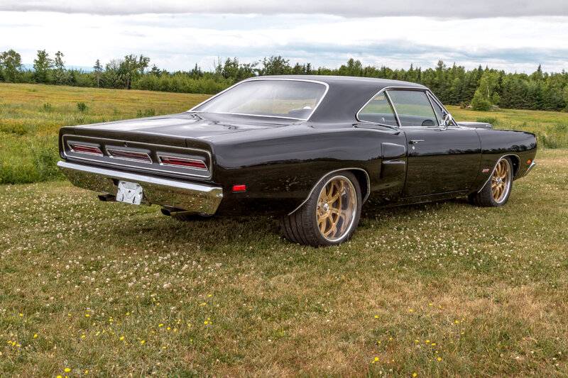

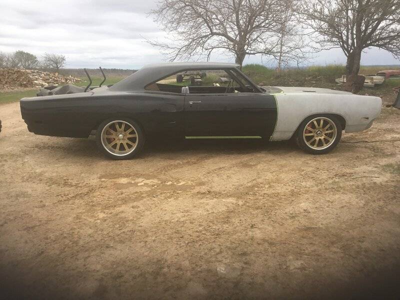

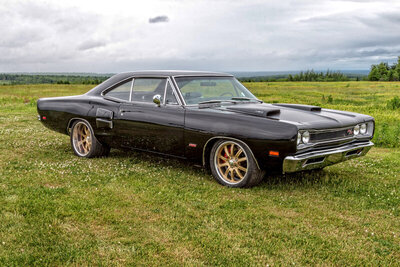

This was my car before I painted it. 18x9 front 19x12 rear. 345/30 and 265/40 tires. RMS front and rear suspension. Handled awesome but the roads around here suck. Car would bottom the rear shocks on the odd sharp bump. If I had of kept the car I was going to change the rear springs. The rear tires didn’t have quite enough sidewall imo. My current build has a rear tire with more sidewall and triple adjustable shocks.
is that 19x12 without a mini tub ? car looks great ! What’s it look like now
With that car the 345 was about as big as you can go. Bought the car as an unfinished divorce sale. Finished it to fill some time in my shop. Went to germany.
