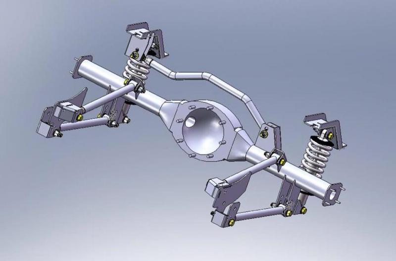

We are going to give this a shot. It is the 4 link setup from control freak.
Interesting 4 link coil over set-up
My chassis guy said "I am not sure it won't work......but I am not convinced it will either"
We are going to give it a shot. I wont have to back half the car with this setup.....if it works....
The only thing I would do different with the rear suspension shown is maybe do a watts link instead of the track bar.
For a drag racing application the added complexity of a Watts isn't worth it.
Is this an equal length setup? Where are the chassis pickup pts? There seems to be virtually no adjustability to it...IC appears fixed unless new brackets are fabbed at all link locations. That panhard is also the absolute WORST thing I've ever seen from a structural design standpoint. Appears little thought went into its design, other than making a '4 link' fit a stock chassis w/ minimal effort.
Its my understanding this is going to be a pro touring style street car rather than a drag car. I dont see the complexity of a watts link either.no more difficult than the panhard bar really.

'4L80' and 'hooking 1000rwhp' doesn't exactly conjur images of corner carving, nor just satisfying pro-touring 'style'.
I'm not sure how more parts, more pivot points, more fabrication, and more $ doesn't qualify as more complex, but to each their own.
I looked into building a TA for my car, but decided against it when I chose to keep manual steering and brakes. I think the OP should maybe consider this option as well...
The only way to make the car do exactly what I want would be to put IRS under the back of it. So this setup is an attempt to hook at the track and still drive down the road nicely. It's about 15k to do a bullet proof IRS.

Then why are you looking at using the poorly/non-engineered piece in that CAD screenshot? Just curious...as a reminder to address the issues I posted above....
Technology is my friend.
Every one is entitled to their opinion. Truth be told it's MORE suspension than I need to hook the car. When you can control your horsepower and torque in 50 rpm increments, it's a lot easier than building a big block that has to leave at 5000 rpm with the wheels up to run a number. I have lots of respect for the old ways. It's just a shame a lot of people think their way is the only way.
