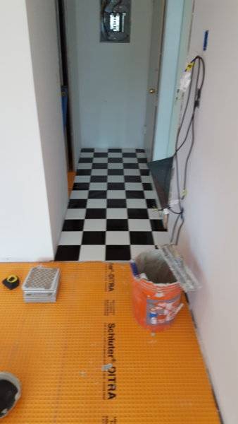

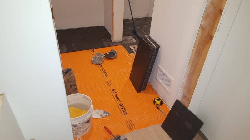

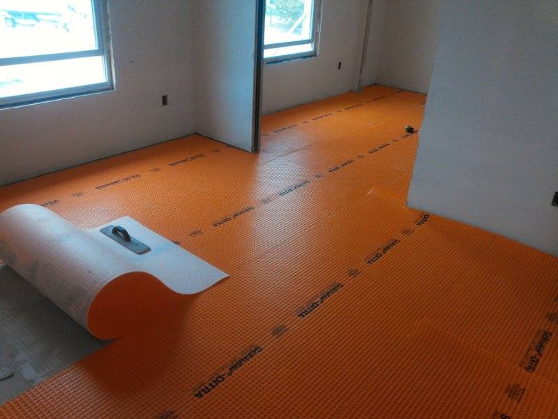

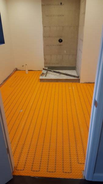

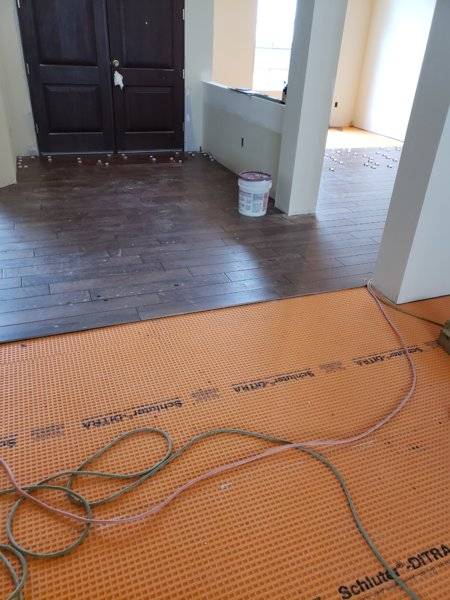

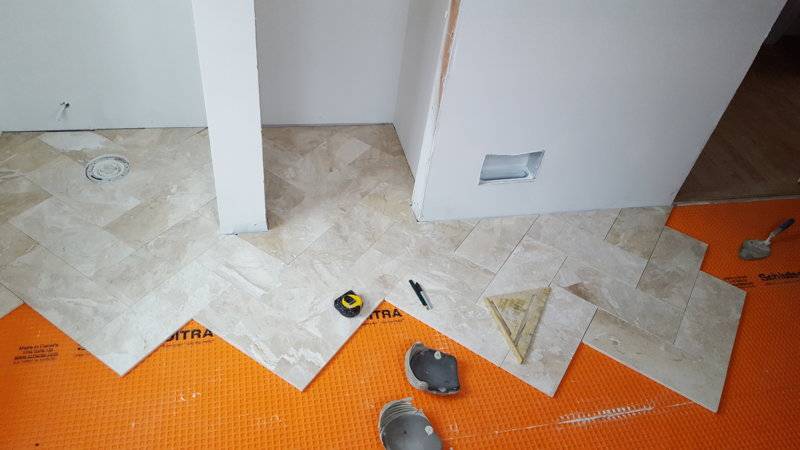

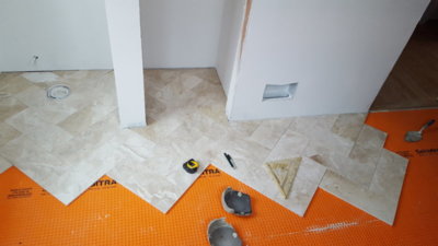

I now use Schluter ditra on any job that will pay the extra money for material and labor.
Schluter ditra is an uncoupling membrane that is great for use over concrete floors.
If your doing the job yourself, it would cost about 750 bucks for the material.
Imo, it's the best way to go.
