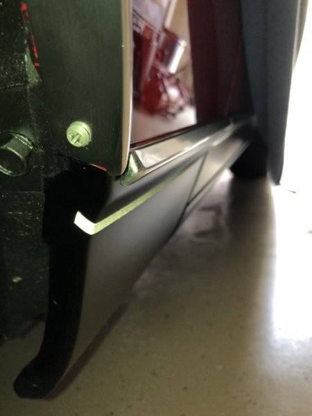

Well I did some research here and I found a few very interesting pics. Here is MoparNation74's factory holes sitting consistently ~.75" above the body line.

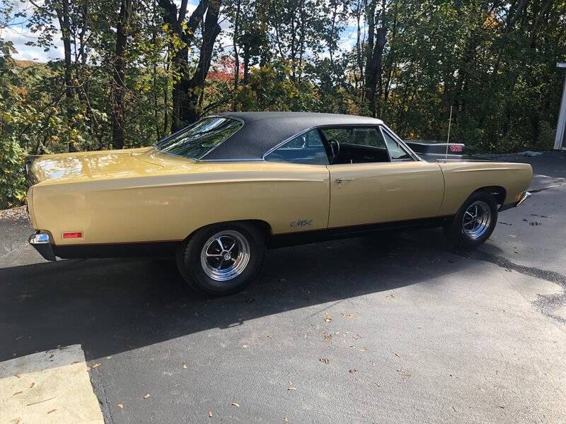

Of course once the moulding is installed it will end up sitting ~.5" above the body line as a result. Here is another member (unfortunately pretty inactive) who shows the stripe sitting equidistant below the body line vs the moulding above it. I've read its supposed to be .75" below the moulding, which would make it a bit lower than equidistant but its pretty close.

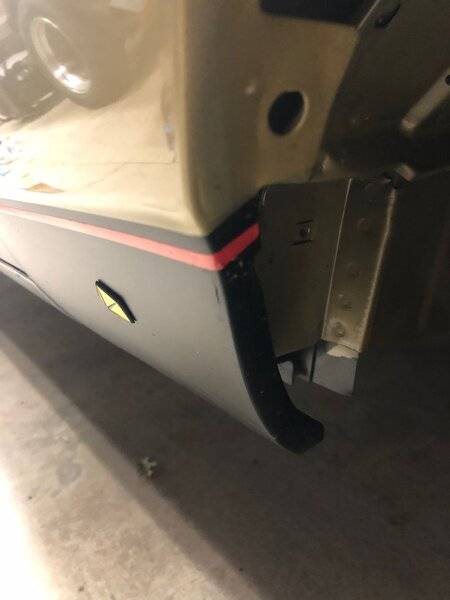

Here is my car, you can clearly see the problem. My black paint stops way too low
about 1/2" from the bottom of the mldg to the center of the body line sounds about right.
