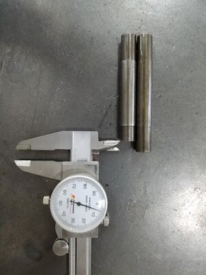

Check this out. I bought 3 supposedly nos pushrods a couple of years ago from a seller in ebay. Been tuning the carb on my Super Bee this summer. Been hammering on it quite a bit while doing this, if that really matters. Down to wot throttle and the last time out it felt like it was running out of gas. Pulled it apart to check and clean the filter. Luckily I decided to pull the pump and check the rod. Wore .305" in about 700 miles.
Take both to a heat treat shop. Have them do a rockwell test on good end. Then ask them how much harder they recommend. And have harden it. Think induction hardening is the way to do it, you only harden near the ends. You don't want it glass hard. If you have several maybe have them do them to different hardness.
It only takes a few minutes to induction harden those pieces.

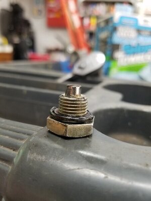

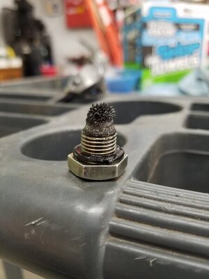

Wonder what the cam looks like. Now all that metal is throughout the engine.
You didnt get NOS push rods. Throw them out and get real OE mopar push rods

My thoughts exactlty. Problem is that real ones are pretty hard to find.
I was thinking the same thing. Probably should change the oil and filter and hope most of it got caught in there.
