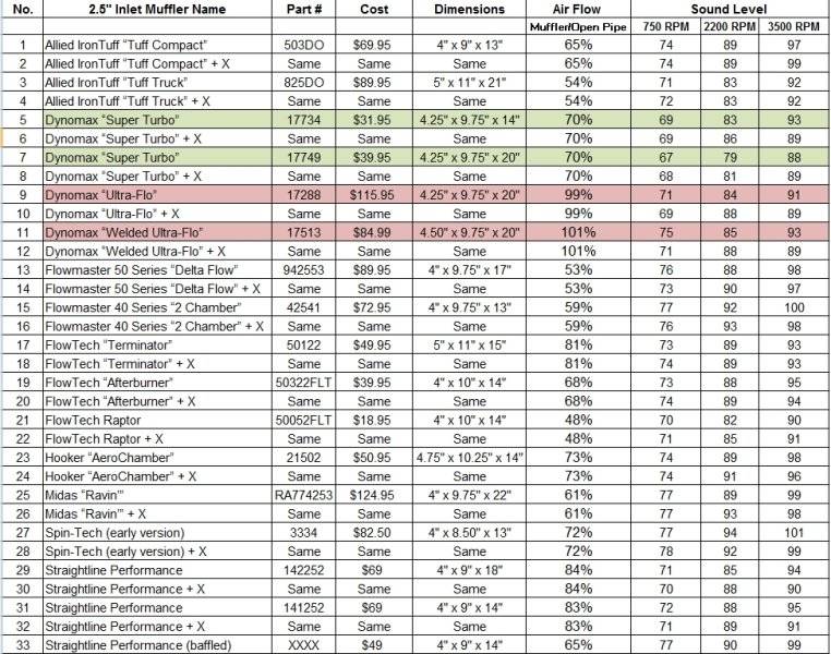

I found a chart that’s been posted all over forums for over 20 years. It says a fm 50 is good for 362 cfm. A super turbo is 410cfm.
Using the calculator of hp times 2.2 shows at 350 horses, I need 385 cfm. If the engine puts out more like what the factory claimed, then obviously it will want the dynomax.
Would it really kill much to be a bit choked up? Either should be way better than a 2.25 system with these Thrush chambered deals.
This chart shows air flow percentage vs open pipe along with decibel readings.
Wow that’s the best chart I’ve seen, thank you! It’s so hard to tell from videos, I thought flip of those numbers from the video.
