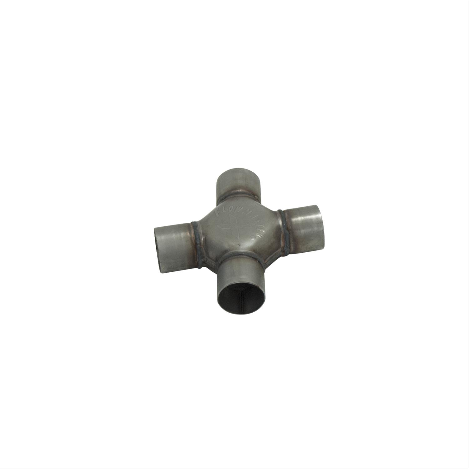

Last question, is this type of x pipe going to do anything special versus a more typical one? The shop has a connection on getting Flowmaster products so I can just have him order one.
That "X" is obviously more pronounced than the typical x, so If you believe an x helps, that would be the one to get.

I have no idea from the photos what is going on in that Flowmaster junction. Must be something new they are doing? I'll go see from their site what it is internally.
Some car guy, if that is an open box inside that junction, I'd be hesitant to use it. I am not sure what the benefits would be, if any. Pypes' X-junctions are much closer to the original Dr. Gas X junctions.

I have an appointment for later in the month. The guy to,d me those Flowmaster scavenger x pipes are for a car that is pushing the li it’s on a system, to crutch it basically. He said typically he sees people use them on a 5.0 mustang with say a supercharger. He didn’t think it would help on this application, but didn’t think it’d hurt if it’s what I want.
