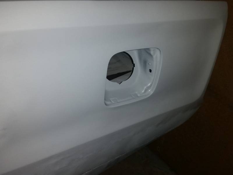

Had a flip-top gas cap on my 67 Belvedere . . . but I've changed it out - so I have almost all the parts to convert your car to a flip top ( if that's what you want )
Here's the original body panel . . .

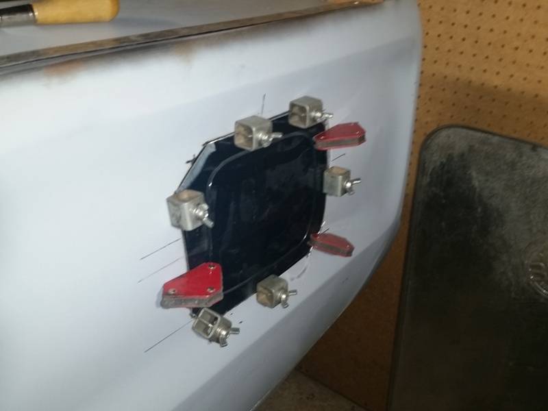

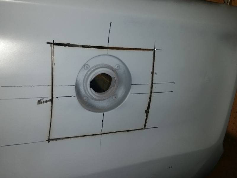

Cut a "newer" flush mounted gas cap off a car at the local pull your own parts car location

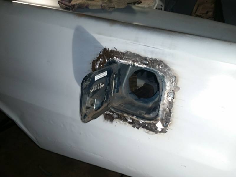

And welded it in place . . .

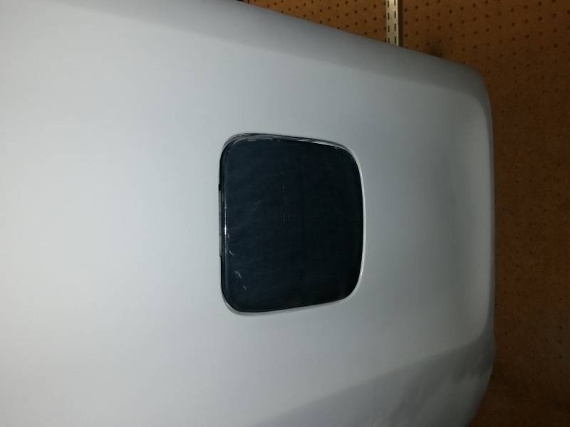

And how it looks after most of the bodywork . . .
And with the cover bolted in place

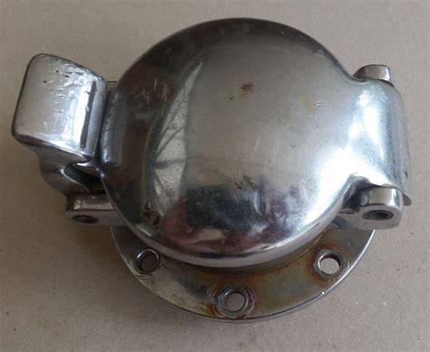

I've decided I want a more custom look for this one. something like this
