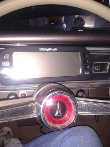

I think this looks sweet.What do you think?

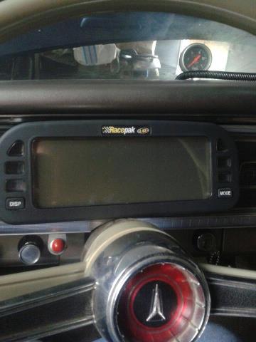

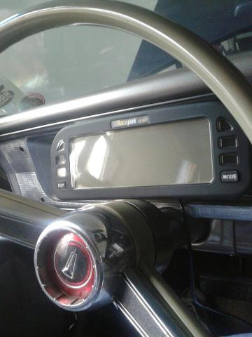

heres a few more.

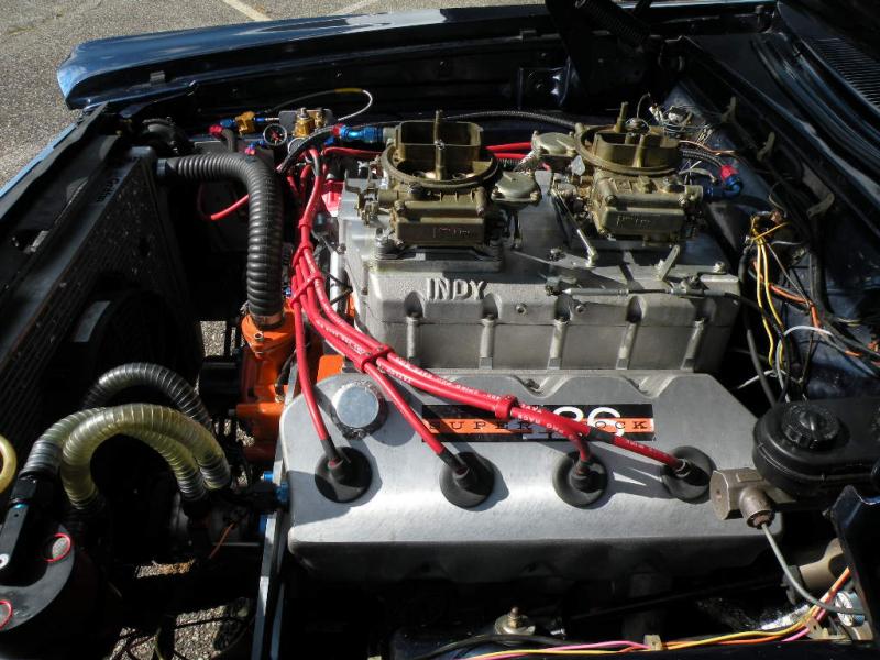

INSTALLING all the sensors and remounting the racepak to the new mount tomorrow. I love talking to myself!!:icon_eyes::upside down::sleepy4:
looks good. i'm thinking about taking the gauges out of my car and installing the racepak dash in it. i need to buy some more sensors for my setup.
