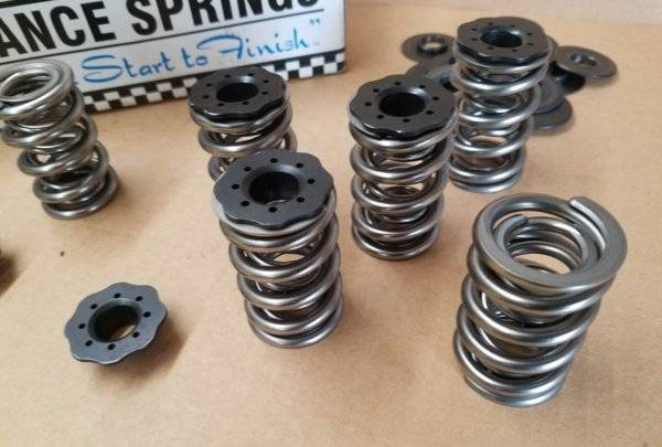

Just bought a set of unknown brand octagon shaped Ti Retainers with holes drilled around the top and Ti locks. They came as a package deal on a set of CT 1574 ML Dual (PSI) springs I bought on fleabay. Said they were only used for a dyno test and I saved about 200 bucks from what this stuff would cost new, so who knows! They will be used on a .262 @ .050 dur .645 lift roller...I also had concerns about longevity but it seems others are having good luck with them.
Anyone know what brand retainers these may be?

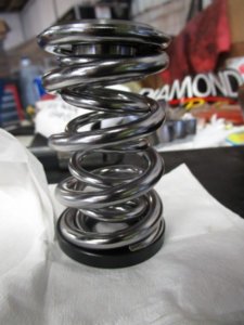

Seeing those is a first for me!
I was told the holes are there to get oil down in between the springs in return reducing friction between the springs and therefore reducing heat. Who knows if it actually helps.

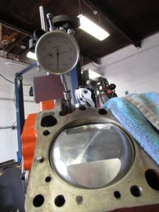

I would still throw them in the spring pressure tester to insure the spec! Must degree the cam.make sure the valves seat right and geometry is on the money!!

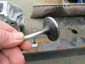

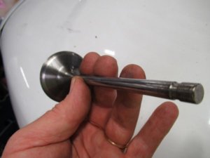

Even though a valve says is is 5/16,,,the stem van vary.The 1st set I ordered was .308 when I needed .310,then went to radial locks.
Need to check EVERYTHING! I learned that early on in my machinist career. Your best friend can machine something for ya but that doesn't guarantee squat. Everyone makes mistakes and misreading a mic isn't hard to do....and even misreading a digital mic happens.
