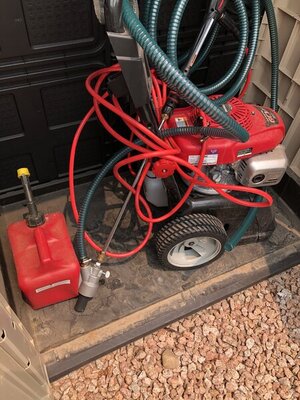

Paint rust undercoating what not. I just got a pressure washer adapter to do hydroblasting. Wanna try it out on my dash since that has so many bends etc that an abrasive wheel should be difficult.

Thanks all, well I am going to try the medium slag grit I got this AM in this set up and will report my findings on a test piece or two soon.
