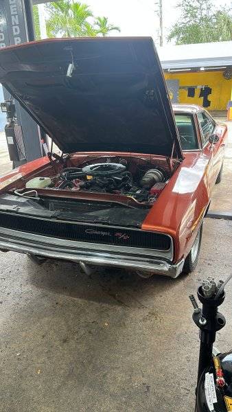

Valve knock under full throttle? 68 charger
Try some Autolite 85's. They last, which I can't make a Champion do.
If blue smoke was a glitch that one time, im think i should try 93, and maybe change the plugs…? What plugs/gaps yall recommend?
If you were smart you would have the timing checked to see what the total advance is. Detonation can cause serious damage. What plug number are you running now? If the timing is ok then try higher octane fuel.
The 2 bbl carb 383 was probably designated to run on regular. The 4 bbl carb 383 would definately require premium fuel. Which do you have? Different octane fuels would have nothing to do with any exhaust smoke - nothing.
But the engine has been rebuilt 6k miles ago so i wouldn't really rely on that.
Given it's not running right on regular i'm guessing the rebuilder probably tuned it for 93 octane.
Well finding out is as easy as putting some 93 in the tank and then floor it (after the remaining regular fuel is out of the tank). :)
I was at the shop bleeding brakes and found one of the rear lines (before the valve) was clogged, so got stuck in the shop overnight. Put 12 gallons of 93 before i went in. Have new iridium plugs on standby to put in tomorrow. Autozone didnt have a timing tool (neither does my shop).
I wouldn't be guessing anything. Get a timing light, check the timing, adjust as necessary.
And if that's the full throttle run that causes a hole in the piston...no smiley face then for the OP.
So good news: put in 12 gallons of 93, drove around a bit, then tried flooring, no more “knocking” and i dont see any smoke! So i assume they “tuned” it for 93… i hope i didnt cause any damage by running regular past 6 years im gonna replace the plugs today with iridium plugs (0.035 gap, right?).

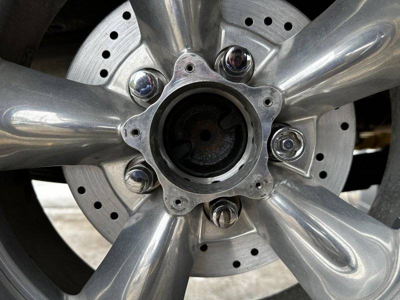

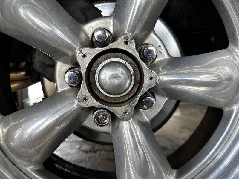

Next item, i guess i never had hub-centric rings installed (and no shop ever told me i needed them)… any advice on sizes? American racing 17 inch wheels
