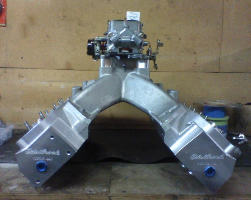

Here is a pic of a low deck indy intake and the victors I mocked up.

2) If you are running a low deck engine (9.98" like a 400 block) and decide to go with a max wedge port window like the heads above there is one place that makes intake manifolds for your engine (Indy Cylinder Head). The do make a single four for both 4150 and 4500 series carburetor flanges as well as a tunnel ram. I will test a 4150 series 1050 QF carb with annular boosters as well as a tunnel ram with 2 1050 QF's on the dyno when we get that far so stay tuned there. I am sure we will try a dominator as well with 4150-4500 adapter.
3) Headers can be an issue due to the raised exhaust ports. TTI makes headers that work however I think some headers might have issues with the torsion bar, especially with the RB platform (10.98" deck).
