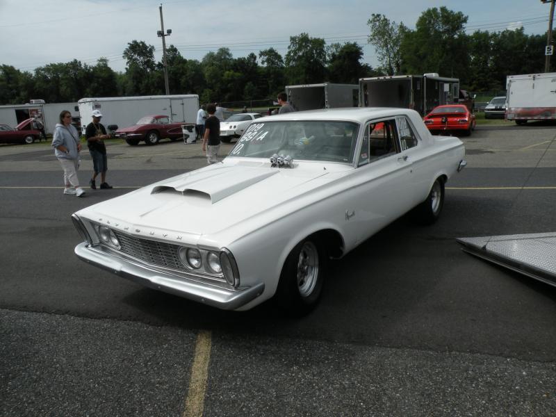

Not much improvement from super stock springs imo.
save the money and ladder bar your car. not that much more money.
I put cal tracs on all my cars. running 9.22@146 mph with a 1.39 60 foot. with no other change but switching to ladder bars my 60 foot times went to 1.26-1.27 and went to [email protected]
that's when I was slow.

Thats one baaad *** ride !!... thanks for posting.

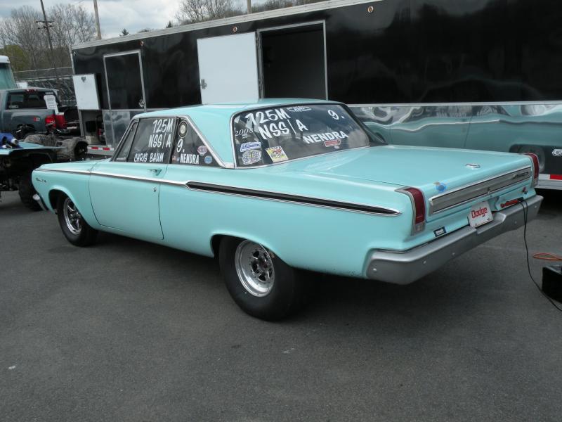

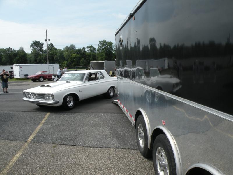

I had cal tracs on my 63 Plymouth switching from ss springs too. going 10.30's with a 1.43 60 foot, switched to caltracs and only got a 1.42 60 foot. switched out to ladder bars and went to a 1.37 60 foot and 9.98-10.04 from 10.30
don't go the cal trac way.its not worth the money.
