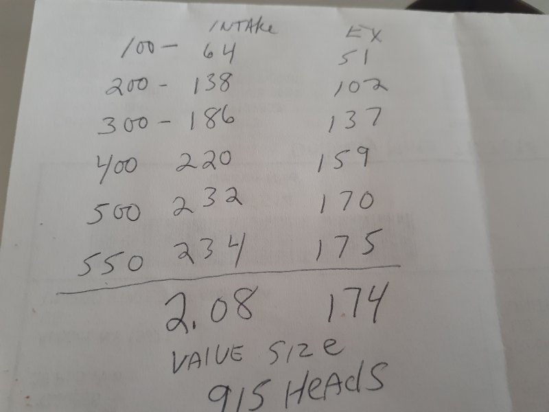

have everything but the intake runner and exhaust. running a rpm performer intake and stock HP exhaust manifolds. rebuilt engine so valve springs and ring seal are good. 168-172 cranking compression in all cylinders.
send me what info you have engine bore stroke what heads etc. just a full list

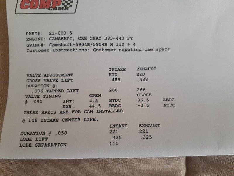

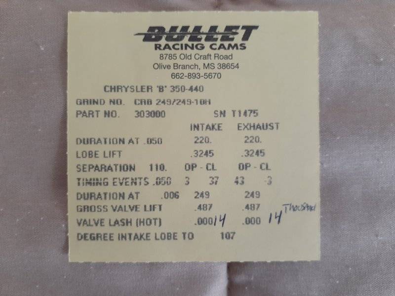

915 heads 1.6 rocker arms. 4.35 bore, 3.75 stroke. rpm performer intake with a Edelbrock 800 cfm avs2. HP intake manifolds. 9.7 compression with 170 cranking compression. cam specs on cards are at 1.5 rocker arms.

Those cams are so close to same it makes little difference. The Bullet cam says to degree intake to 107 still a 110 center line. So I did the Comp cam at 110 intake center
Comp cams peak HP 429 avg hp 300 peak torque 503 avg torque 419
Bullet cam peak HP 424 avg hp 297 peak torque 505 avg torque 420
The Comp makes max HP at 5000 rpm the Bullet 4500 rpm both cams peak torque at 4000 rpm
program says 178 lbs cranking with the Comp and 186 with the Bullet
with 87 octane fuel some issues with spark knock idle to 4000 rpm
It is showing a curve of 14 degrees at idle then start to advance at 3000 rpm to 20 degrees then to24 at 4500 max timing 33 degrees
I used 1 7/8 headers 38 inches long with open exhaust.
idle vacuum is 17 inches so you will barely hear a lope at idle.
If you leave the centerline at 110 increase the duration of the intake to 224 and the exhaust to 230 same lift, you drop idle vacuum to 15.5 inches and increase the HP to 441@ 5000 rpm and torque stays the same.
thank you for doing that. you saved me some work because I am running the bullet cam now and have the comp cam too that I was going to put in but now not worth it. Yes I have 17 vacuum now with a slight lobe. l am running the comp cam in my other car but it was 217-221 that 221-221 I had comp make it up for me hoping it would make more power than the bullet cam. the comp cam looks like it will carry the power better in the upper rpms. running 90 octane 12* at idle 33-34 total all in at 3200 rpms.
the comp cams is like going up 1 cam size from the bullet cam at the .050 duration. power should hold up better after 4500 rpms with the comp cam.
the comp cam is definitely better all the way around. picked up 1.5 tenths .
