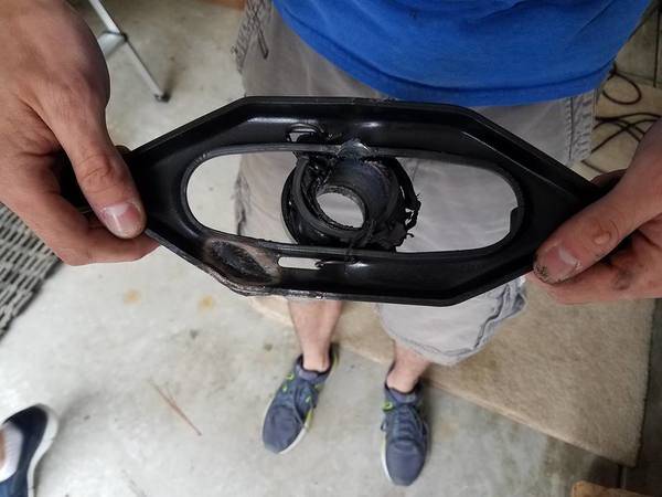

So just an update for anybody who might be looking to do this. We lost our fork and throw out bearing in our first race. We have found that we needed an ax15 Front bearing retainer from a dodge dakota. It is a direct swap over but has the sleeve for the throw out bearing to ride on. We just installed everything back in and the clutch seems stronger than before. Will update later with destruction photos.
So here was the damage. Seems not running a sleeve on the throw out bearing was allowing it to shift. Just needed up failing and shoving the fork into the pressure plate. Amazing failure but should be an easy fix.
