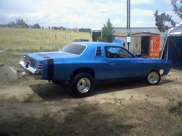

Well Super77 you have seen mine..but I'll post a bit more, she running a 360 thats been bored and stroked to a 420cui, heads ported, polished, CC'd, relieved over size stainlees valves, match Flowed, and cut .040,with a VERY well built TCI 727, 3:55 gear sure grip for street and a 4:10 for strip,...this weekend ran a 7.72 @91.35 mph 1/8th mile

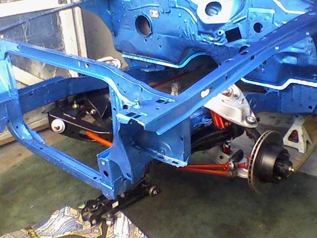

I'm working on some body issue's with my '79 XE that was dealer striped a GT (no stripes today) that I got from the 1st and only owner. It was a 318/904/8-1/4, 2.76 peg leg car with a split bench that was swapped out for buckets and a console with Gt parts. They look better.
The 318 gave way to a 400/727/9-1/4, 3.55 cogged rear. It has since moved on to a '71 Duster for fun.
The new engine will be a small block and a 727. Not sure of final displacement yet.
245/60/15's on all 4 corners. Looking to make some high output torque engine. Big HP not a concern. It'll come naturally.

YY1 ...why yes it does...SPECIALLY when she ran a 7.51 at 2 clicks under 100mph in the 1/8.....anyway....DEFINETLY !! interested in that 75 ..anyway you get some pix and a contact number for me... I have this ider to build a full chassis car with a 75/76 acid dipped body, lexan, and fiberglass front end...don't ask why....Just cause....LOLOLOLOLOL call it shock value !!!!!

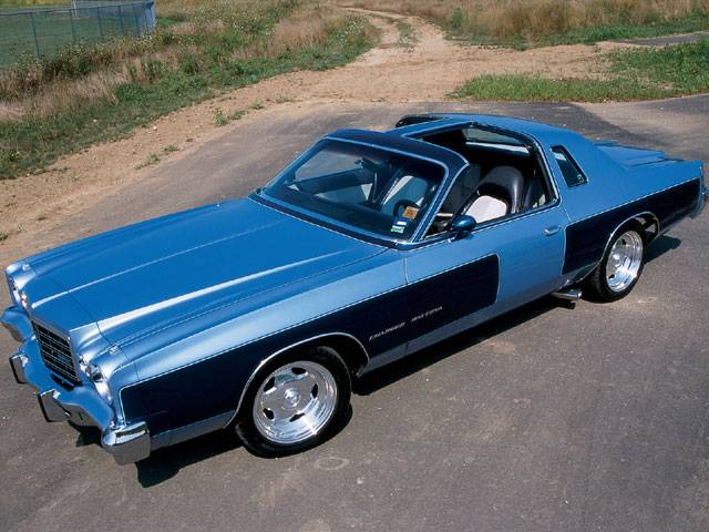

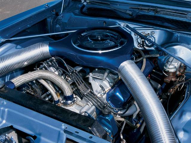

Thanks for the kind words, Super 77. All of these rides in this thread are super nice! Your Charger is very cool, nice work! I love the old school vibe and stance on it, but yeah, getting it down a little bit couldn't hurt. (Does it ever?) I looked last night and couldn't find my most recent pics of it, but here are some older ones that show most of the updates to date. Sorry some of them are crappy cell pics, but you get the idea. As you can see, most of the changes are actually under that huge hood! Stay tuned on this channel as well, as the next month or so is gonna bring a Dana swap, some CalTracs, and a even a little bit lower stance into the picture.
you did NOT turbo charge that 400/440 ? that is sick ! you dont know how much that motivates me. i have literally spent the better part of 2 years searching for anyone that has done ANYTHING with the dodge 75-77 B Bodies and the people in this thread have been as close as i have come. i have even had people ask me why i would waste any kind of real money on this year of charger, and i have been insulted by the doba haters out there LOL. the 77 charger *** end treatment was 77 charger only with the exception of the 2500 78 chargers that came to a stop when the magnum took over the XS22 body code. back in the day, our neighbors brought home a brand new 1977 dodge charger daytona that had a yellow /orange/red 3 tone color daytona treatment that i will never forget. there were just over 23,000 XS22 chargers for 77 and im sure 3/4 of them are gone. keep the pics coming and it is a treat to have you here...by the way , what color blue is that ? it looks to be a B3

Thanks again, 77! I agree that these B bodies just don't get any love. At shows I am always hearing stories about how they had one, or their parents or their neighbors had one and how they always liked it, yet very few choose them for builds. Kind of odd, I think. As far as the engine setup, it's a 469" low deck stroker with ported Stage 6 heads, with a Procharger blowing through a custom intercooler and a Demon carb.
The color is Cadet Blue/Starlight Blue metallic (I think it was code PB3).
Incidentally, your car is totally sweet! Don't listen to the haters, keep on doing what you're doing, man. I love the older stuff for sure, but it would sure be boring if nobody dared to be different with their builds.
