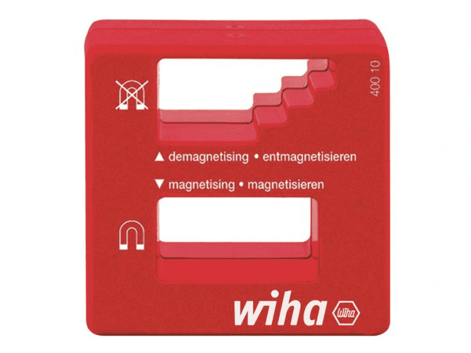

I use one of these often with my screwdrivers....
Very handy for creating a long magnet for picking up screws and swarf when working on electrical panels....and de-magnetising afterwards of course.
Electricians screwdrivers develop magnetism while working, so it pays to have one of these on hand.
Of course, the traditional method was to just give the end of the screwdriver a good thwack on a solid object.....usually gets rid of about 90% of the magnetism (seat of the pants measurement there) :p
