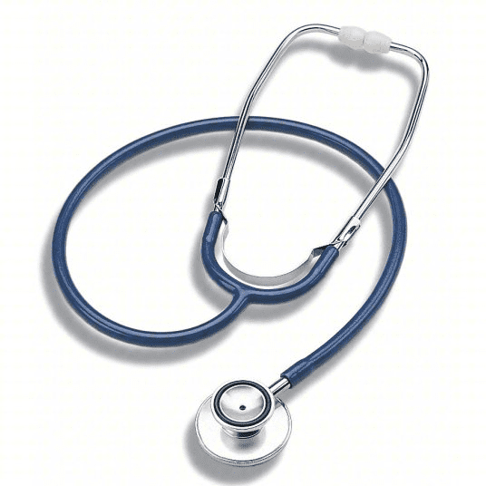

I hear ya. I would not have guessed the fuel pump either. Like i said, I found it by accident. My engine ran great but it was messing with my mind big time. I was imagining being stranded in the middle of nowhere. I knew it was on the passenger side since my stethoscope showed it more prevalent there but I couldn't pin point it. I can't remember any issues with the arm being banged up but I do remember the weak spring as to the cause.
I sincerely hope it is your problem as well since it is an easy fix. Good Luck!
I don't recall if I tried my stethoscope probe on the fuel pump itself but I should have for sure.
