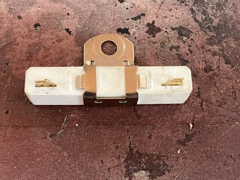

Your Ballast Resistor , what OHM rating is your ballast
Ballast a def weird one. I’m used to them having the starts and then does after you let off after starting” scenario but this year it was on cranking and went through all the usual steps and swapped ballast and bingo. Looks like we both members of the ballast club this year. Glad to hear she’s betterI have the FBO advance limiter plate but that is all I have from them.

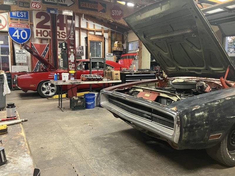

Rich, AKA CoronetDarter came over in the Coronet. He brought tools and was a welcome help. He has a form of electronic ignition so we used the Coronet as a test mule along with two other cars here and a truck. We tested voltage at the coil and ballast on the Coronet, my 72 Duster:

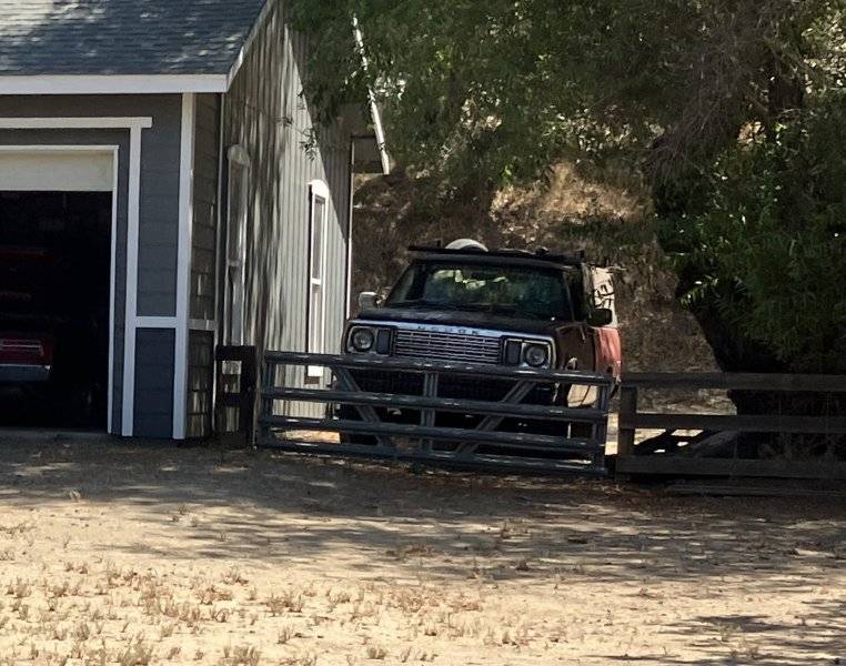

A 75 Power Wagon:

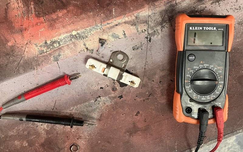

Yesterday on the roadside, the car was untouched and not starting so my diagnostic list was 1) Check for fuel, 2) Wiggle wires looking for loose connections 3)Replace ballast resistor. Each thing I did was followed by trying to start it.

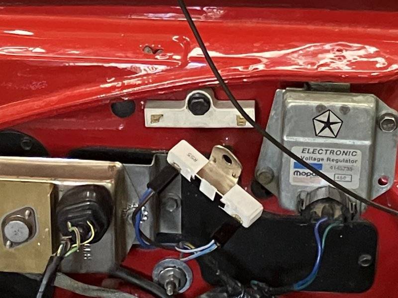

At home I figured the ballast resistor was fine since changing it made no difference so I put it back in. I charged the battery. This morning I put in a different ECM and still no spark. Rich noticed that the plastic connector to the ballast didn’t click on with a snug fit. He thought maybe it could be partially to blame. The terminals on the BR wiggled a little, I don’t know if that matters. I think It is a ballast that came with an MSD coil, I don’t recall. All the times I’ve had random no spark issues, I’ve swapped around parts. I don’t remember where all the stuff came from.
I replaced the ballast resistor with a spare from the shed and BOOM, it starts and runs!

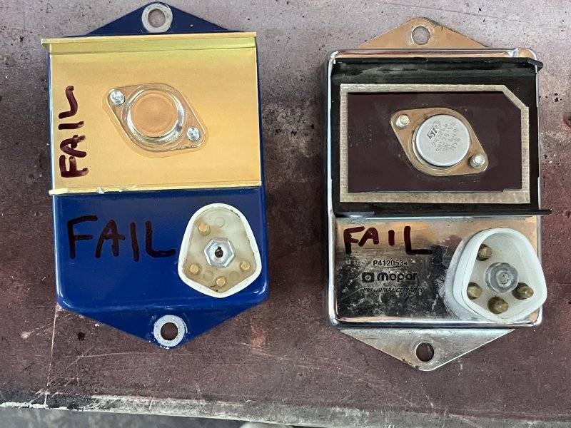

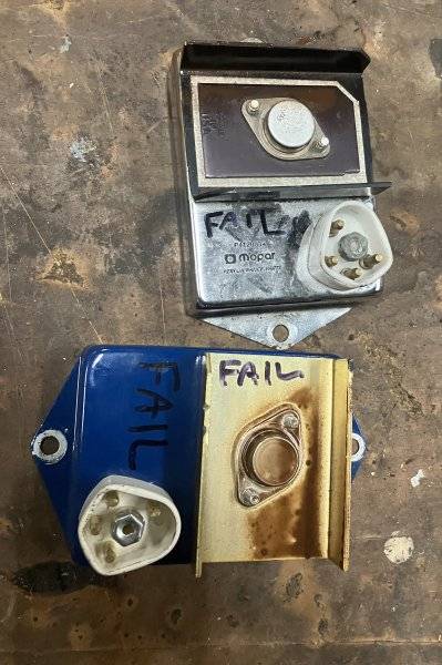

That is a generic parts store ECM that is supposedly rated to about 5000 rpms. It is fine for now. At this point, I knew the ballast resistor was bad but To confirm things, I tried the blue ECM I was using along with an MP Chrome box.
I tried the blue and chrome boxes in the Duster and neither one worked in that car either.
Yes, I threw them out. I have made the mistake of putting junk electronic parts back in the shed only to be pissed later when they don’t work.

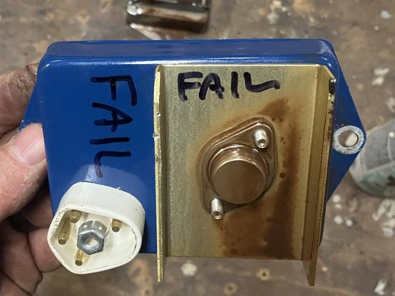

This time after testing it I spritzed it with brown paint to remind me that it is crap.
This chrome one was on the car awhile back when I lost spark so I marked it too.
I tested the ECM from Ginger on the other car, Jigsaw.
It started right up. In fact, I tried a couple of ECMs that I thought were bad and they worked too.

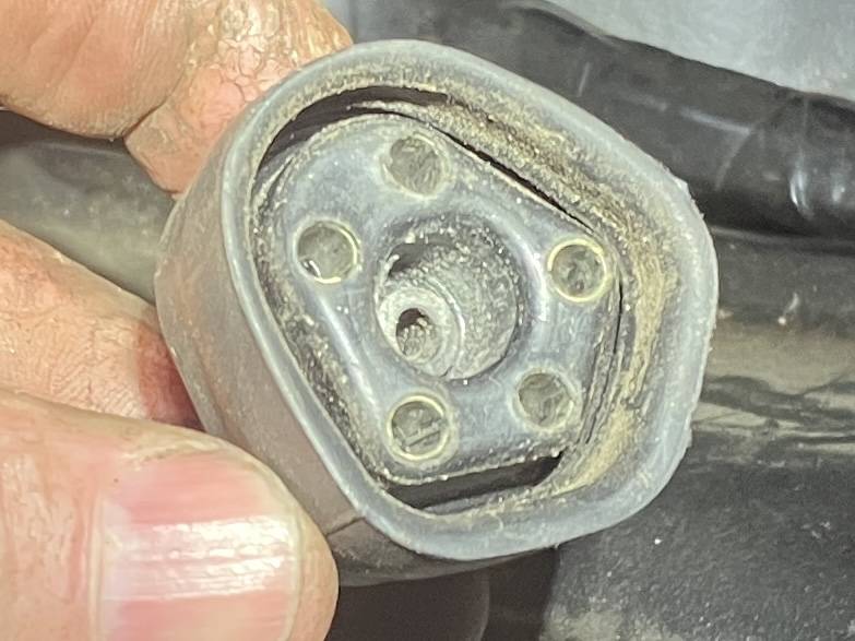

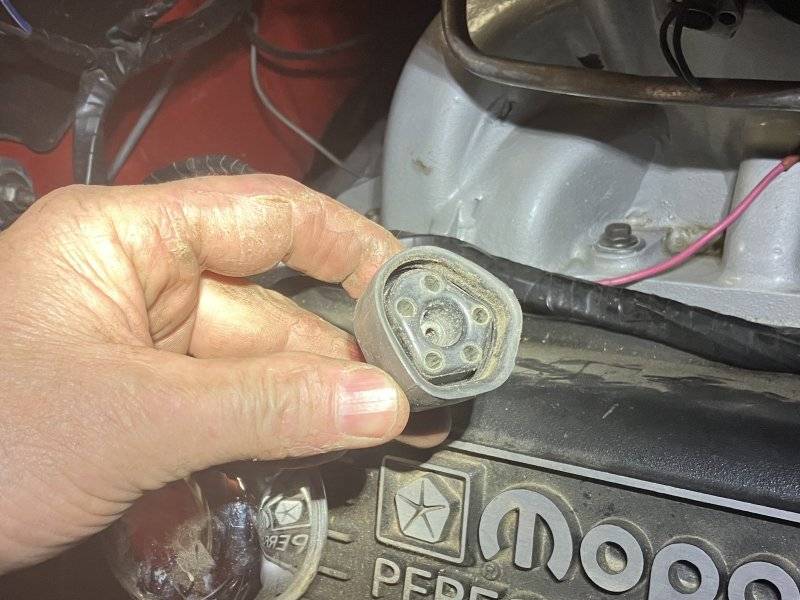

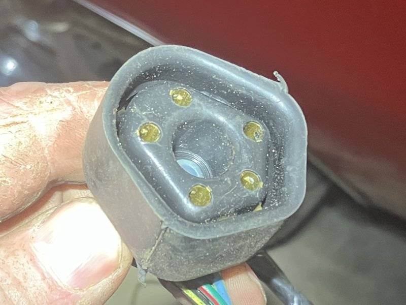

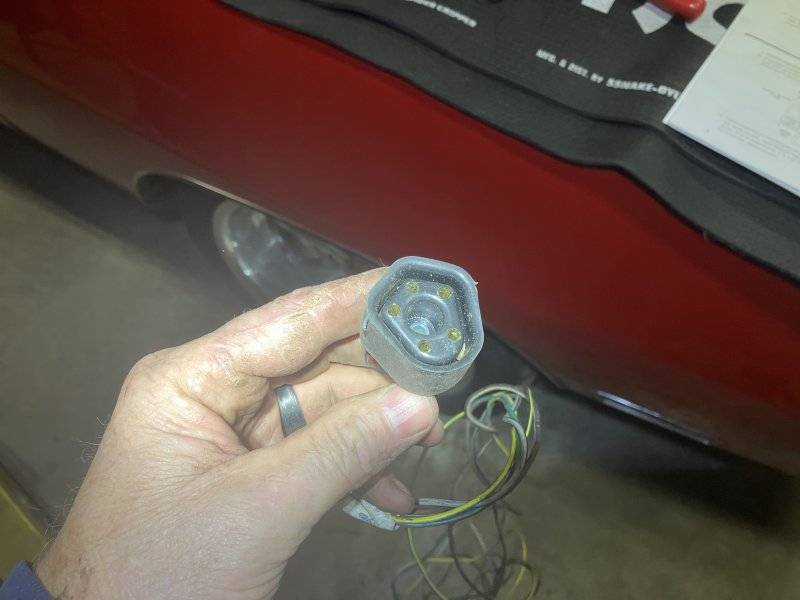

Maybe try cleaning those grungy contacts and so dielectric grease?I did notice this…
Here is a new harness for a conversion:
The contacts all look pretty, huh?
Now look at the one in the car.
The terminals are grungy but are they bad enough to be an issue?

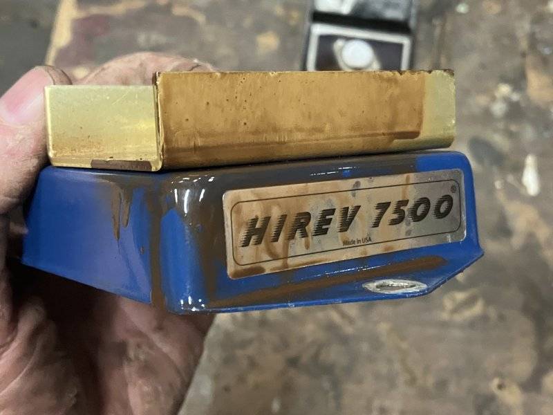

Goo and electronics... Probably popped a capacitor.Autopsy that blue box - see what's under that transistor cover?
