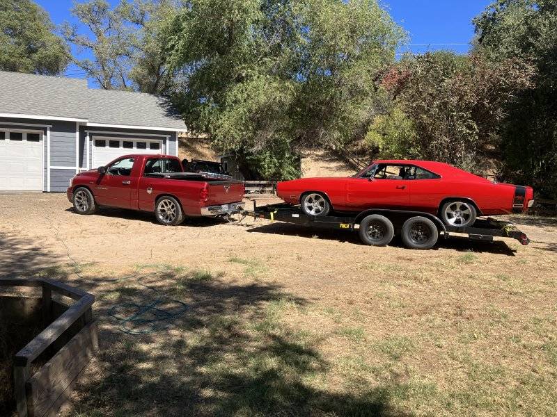

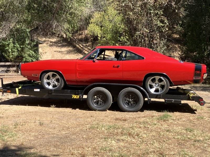

Just when you think that you have a situation solved….
I have to state that at least when you have a shiny car on a trailer, people think you’re going to a car show.
Months have gone by with not one instance of no-spark.
Today I had her out and after rapping it up to 6000 in 1st gear, it started to stumble then shut down. I thought I was out of gas but the accelerator pump shot was strong.
It cranked fast but almost in an instant, slowed way down.
The wife came out, I went back for tools and parts.
Nothing helped. At times it acted like it wanted to start as I released the key. This symptom occurs with other cars I’ve had and I’ve yet to determine what causes it. No, it isn’t the ignition switch. I’ve tried a spare numerous times. The battery was down to 12.1 volts so I used the Hulkman charge box. It still cranked slow as if the extra reserve power meant nothing.
I’ll report more as I get deeper into it.

No reason to hit the like button. Sucks chasing electric demon.

Man, that sucks. At least you have your own trailer so the car isnt on the Flatbed Ride of Shame.
With all the new parts you've added the problem seems to circle back to wiring or connectors.
