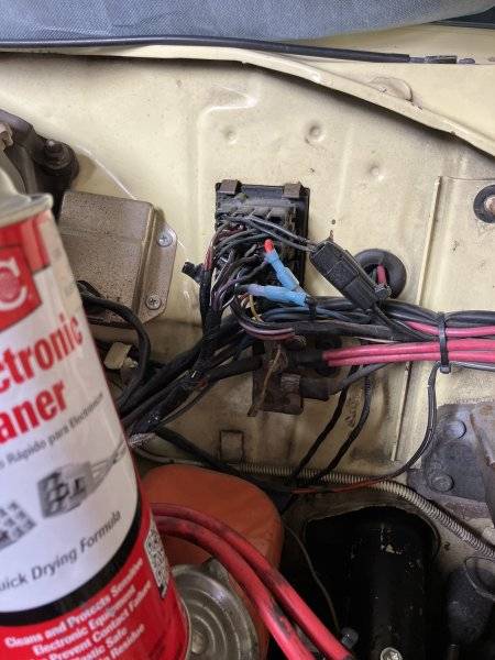

Ignition switch
Nope. A few times when this has happened, I have slipped in a switch from my stash of parts and it made no difference.Ignition switch
Aurelio's probably isAnyone making cannoli for Easter?![]()
I hate dealing with hidden electric hiccups.Nope. A few times when this has happened, I have slipped in a switch from my stash of parts and it made no difference.

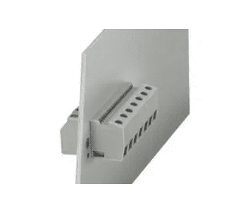

Those are actually a spring clamp (no tools required) style.WHY don't you just eliminate the bulkhead connections (the way MOPAR did it) using MECHANICAL BOLTED CONNECTION FEED THRU CONNECTORS. The devices provide insulated independent connections on both sides of the fire wall in lieu of the Packard mechanical method, thereby eliminating or minimizing to potential for corrosion depicted.
Similar to this:
Adjusted to the number of wires, their gauge (ampacity) wanted or needed., thereby eliminating the "troublesome" Mopar connectors. It'll look different but to those who are retro-fitting EFI or brand X ignition system why would it matter? Mounting the feed thru terminals will require a little inspiration.....just a thought and my opinion.

Well, I hope that it is. I found no smoking gun, just some slight corrosion/crud on the spades and sockets in the bulkhead connector. Time will tell.Is that still acting up? I thought it was fixed?
