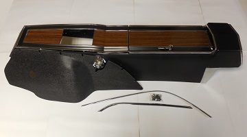

As purplebeeper mentioned, the auto and manual consoles are different. The top plate is different where the shifter goes through the console. Additionally the drivers side of the 4 speed console has a cover piece covered with carpet that sticks out to accommodate the 4-speed hump and a different chrome trim piece.

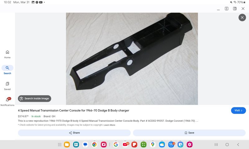

The main body casting between the 2 are identical. 4 speed is just cut out. And higher holes for trim

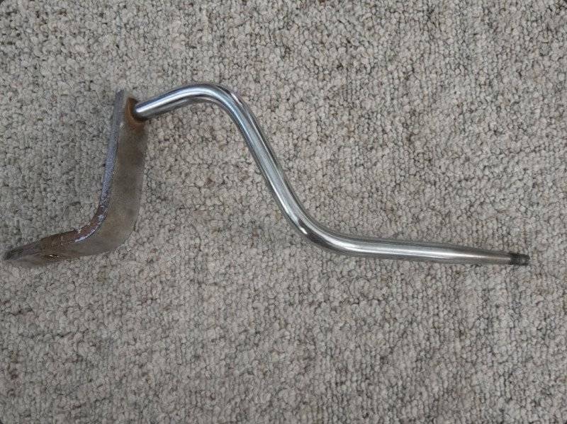

You also need a 4 speed console shift handle with the dog leg in it. Non console 4 speed shift handle doesn't have that.

As others have correctly noted, you can cut/modify the auto console for clearance, add the drivers side "hump" and drill for new 4 speed trim that sits higher. There is a hump for sale on e-bay right now (1966-70 Original Mopar B & C Body 4 Speed Shift Console Hump Cover | eBay), I'd scoop that up if I were you.

He will only ship to lower 48. Are they available aftermarket?
Admittedly I did not get that far when I had the auto car, I had just found some used ones popping up here and there on e-bay and planned to grab one when I was ready. A quick search did not turn up a manufacturer for a new part. I know the sheet metal for the floorpan hump is readily available from AMD, as I did buy one of those.
