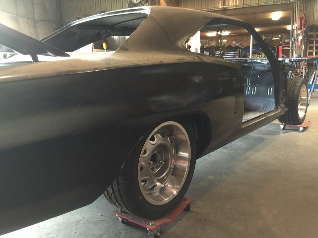

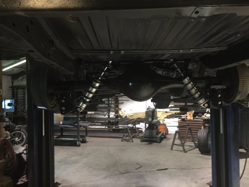

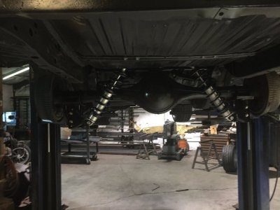

We are in the middle of this build and i think they look awesome!
If I'm not mistaken those are the 17s from Year One. A couple of my brothers customers have them on their cars.
Yes your correct I bought them last year at mopar nationals from year
one. Couldn't pass them up they look so natural on this 70. This car
also is set up with coil overs and 4 link in the rear from ride tech suspension. It is a work in progress but we feel we are on the right track!

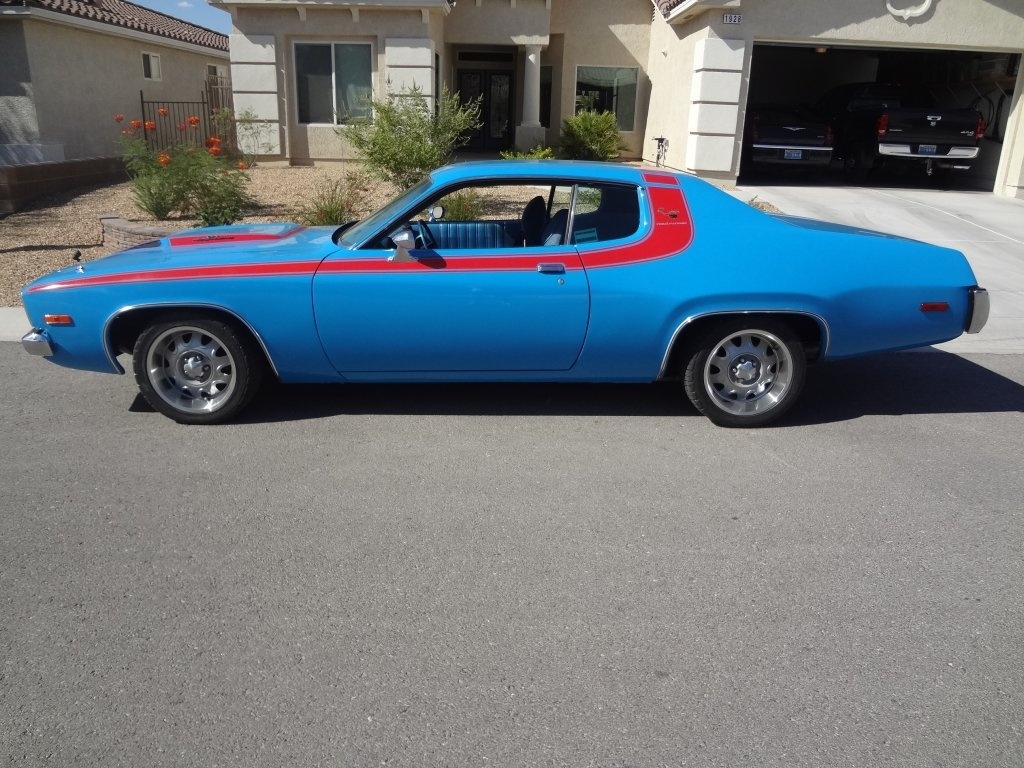

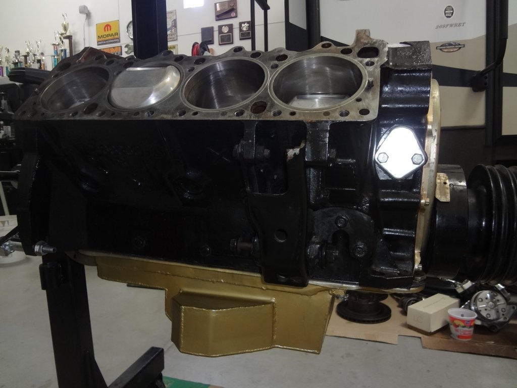

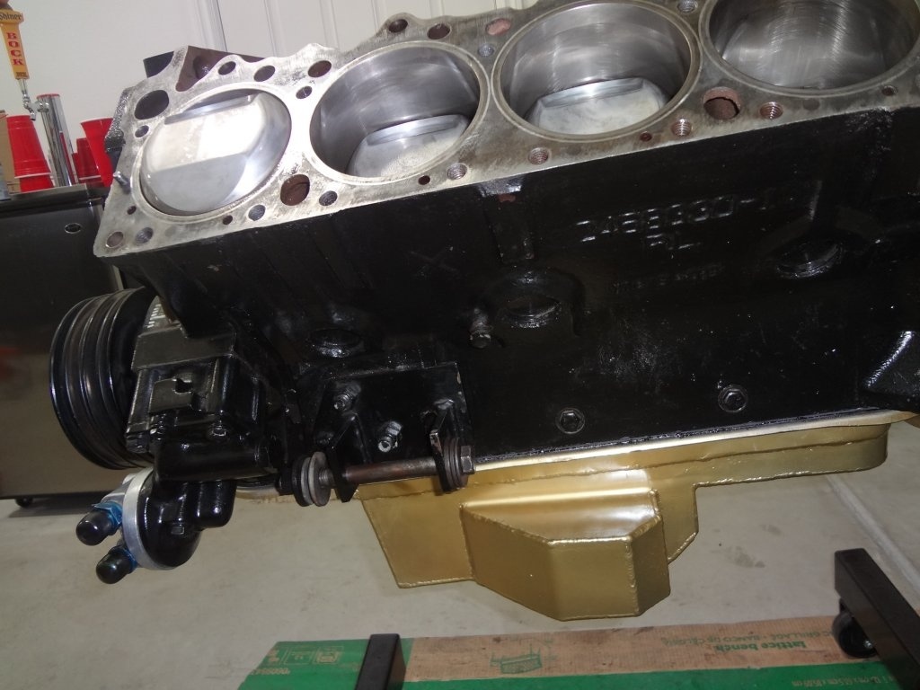

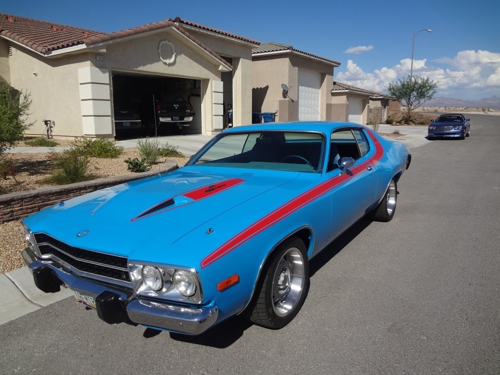

How did you mount a hemi in your roadrunner? Motor plate? Aftermarket suspension? Nobody that I know of makes conversion mounts to put a 426 style hemi into a 73+ car. Thanks. - David
I used my original 440 motor mount on the passenger side and used the old Roland Osborn (NHOA) Elephant Ear solid mount on the Drivers side. I used the original K-member and suspension.

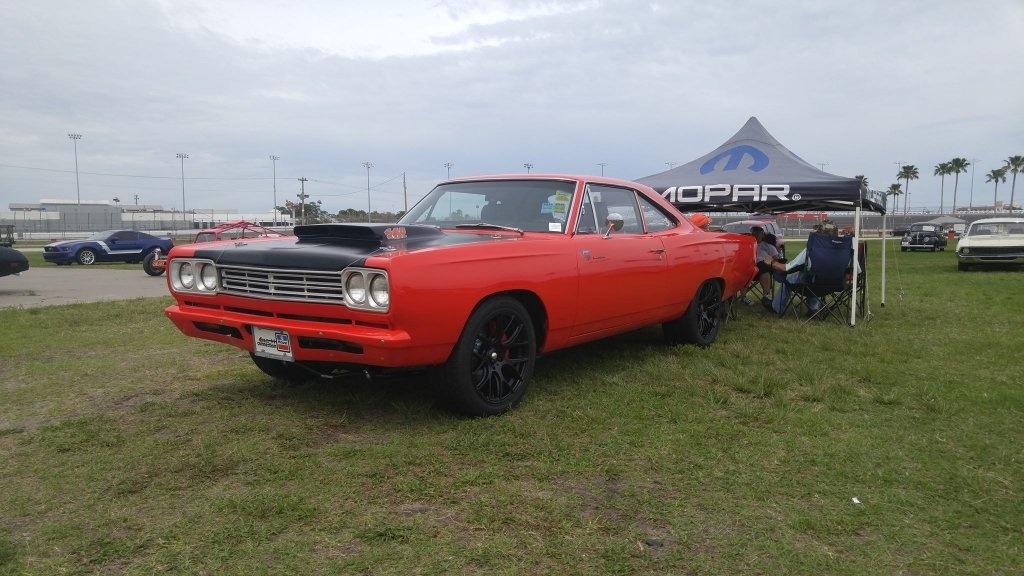

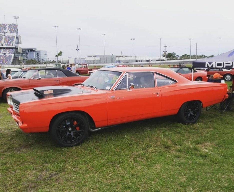

Hello Tommy,
I see that this original post is few years old and I wanted to see if you were to do it again would you go with the same size of tires and rims? I'm very close to buying the tires and rims for my 1972 GTX and I'm trying to make a well-informed purchase. I noticed your rim size but I'm not 100% sure on the tire sizes.
18x9's front w/ Nitto 555r2 255/45r18
18x10's rear w/ Nitto NT05 295/45r18
6.3" backspacing, 1-1.3" positive offset.
