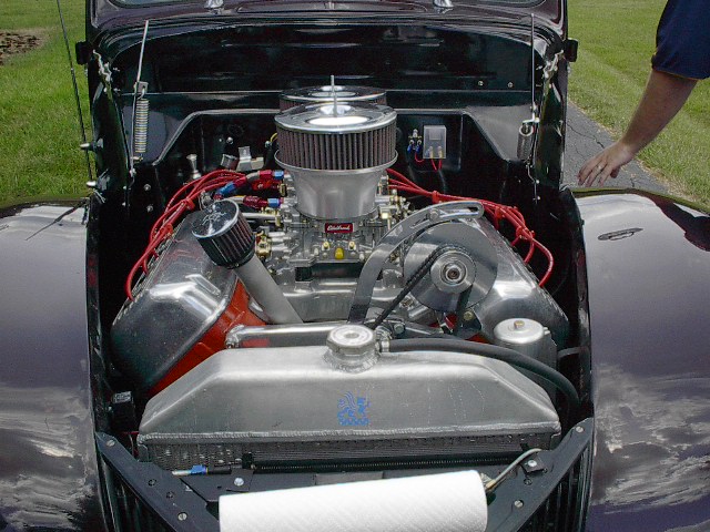

Took a look at your website. Quite a project you got going with the 392 into the 65. I put one in my 40 ford and it is well worth the effort. What cam did you pick for your build? Pic of mine in my 40. I used alot of parts from hotheads as well as PAW.
I dig the older hemi's.
