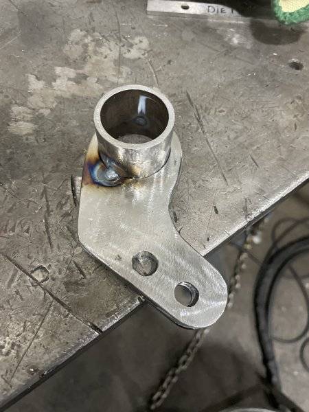

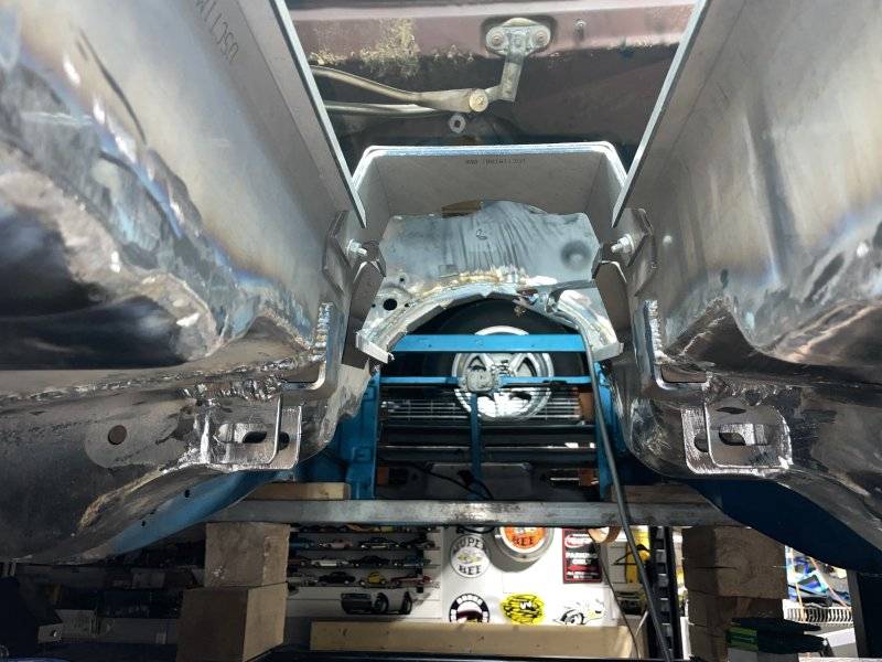

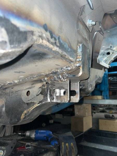

Fab’d up the patch for the wiper motor bulge clearance. Patch for the clutch cable clearance. Also found the USCT TR6060 trans mounts sat too low at proper drive train angle with the QA1 coil over K frame. Fab’d up new tabs to lift the mounts up closer to the floor to make room for the exhaust. Welded the mounts into place, connecting them to the cross frame. Next step is getting the firewall and underside prep’d for paint.

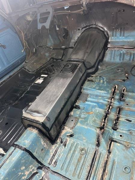

Finished up welding in the trans tunnel covers, welding in a patch to fill in the front half moon clearance in the support arch, cutting out the shifter clearance in the arch and cover. Also cut out and fab’d in a pipe for e brake cable clearance in the SFC. And made some seat mount stiffening plates for the passenger side.

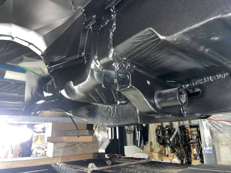

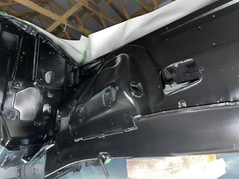

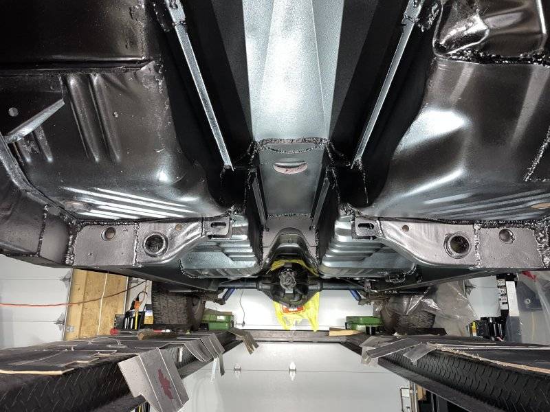

Rattle canned the engine bay and front frame rails with satin black frame and roll bar paint. Coated the undercarriage with a coat of primer and then two coats of rattle can spray on bed liner. Was a bit of process painting without it being on a whirly jig but I’m happy with the end result.
Next up when the temps are back above freezing next week is seam sealer application at all possible leak points in the firewall and trans tunnel.

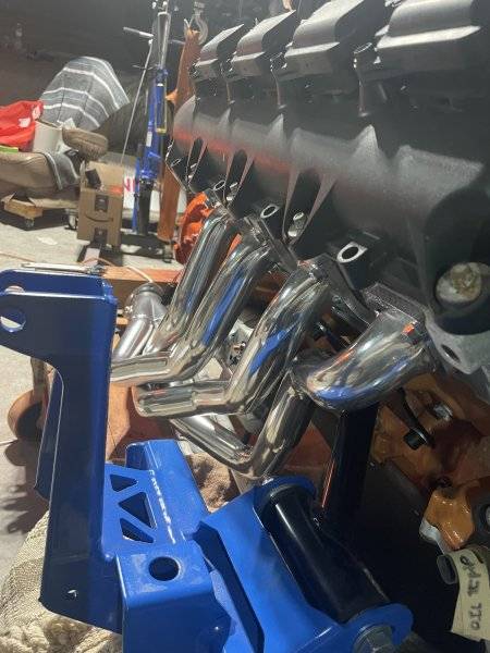

Got the TTI headers installed today. After swapping out the original starter for the mini, they bolted up fairly easy. The head gaskets stick out past the head and the block so I needed to bend the excess down slightly so the header flange would slip past it.
Applied seam sealer to the underside. Covered up the welded areas and made sure to fill all gaps that could let moisture in.

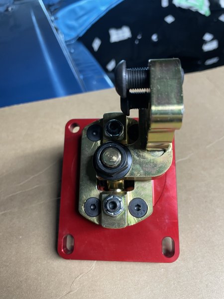

Decided on a direct mount shifter for the TR6060. Went with the Racetuning base with positive stops. I’m very impressed with fit and finish as well as the feel of the centering for 2nd to 3rd shifts. Highly recommend! Customer service was great. Fast replies to text messages also very helpful.

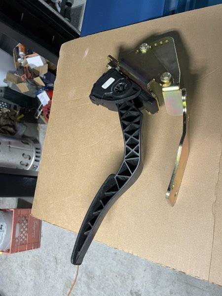

Picked up the USCT DBW pedal adapter bracket as well. Feels good and sturdy, lots of adjustability. Need to shave a bit off the side so it fits around the firewall eyebrow though.

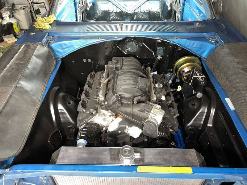

Mounted the Leed Brake booster and Wilwood master cylinder. Not a big fan of the install instructions for booster bracket and the linkage in the interior. Need to get a LH bracket for the Wilwood proportioning valve, can’t mount it with the RH bracket due to the fender interfering.

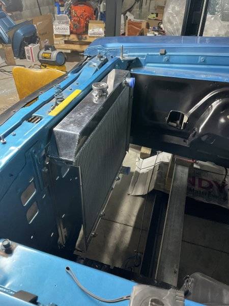

Four core Frostbite rad and Frostbite fan shroud. Not impressed with the lack of mounting hardware for the shroud and fans.
Installed the drive train for what I hope to be the last time. Lots of room between the Holley mid mount and the cooling system. TTI headers have lots of room and clear everything.

Pic of the trans mounted with customized mounting tabs.

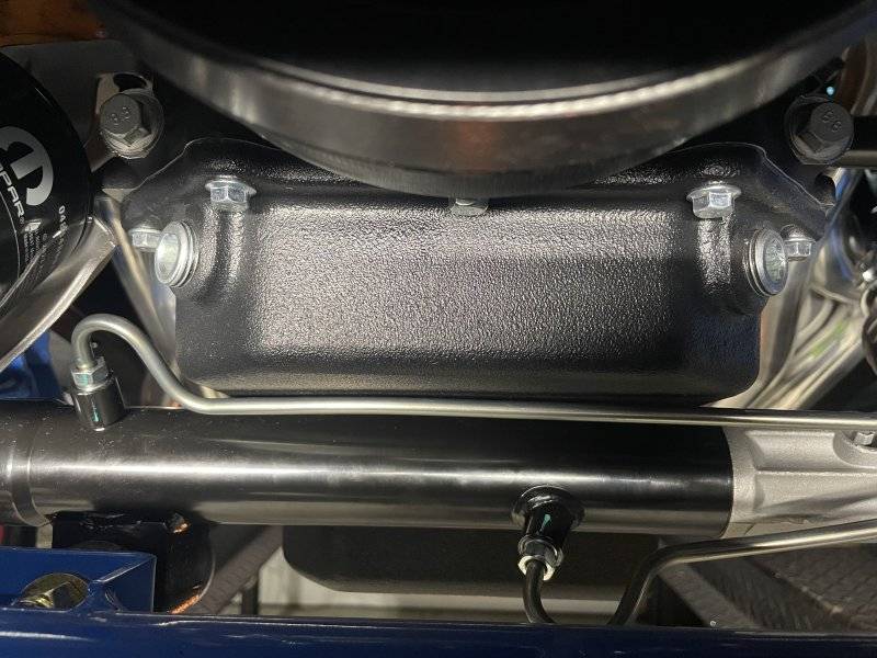

Installed the power rack. There’s not much room between the hydraulic lines and the Holley oil pan. Just enough. The rack fits in with the 45 deg filter adapter.

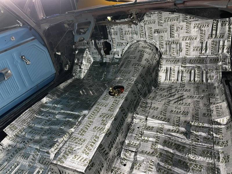

Used 120 mil Siless sound deadener on the firewall, floor, trans hump and up the back. Might have went a bit overkill, it’s not a race car so a bit of extra weight for some sound proofing and heat shielding is ok. Used just under 60 square feet to cover everything pictured. Have 50 mil Siless for the doors, roof, trunk and trunk lid yet to be installed. Might even put some on the underside of the dash. Putting a decent stereo with subs in it so I don’t want rattles.

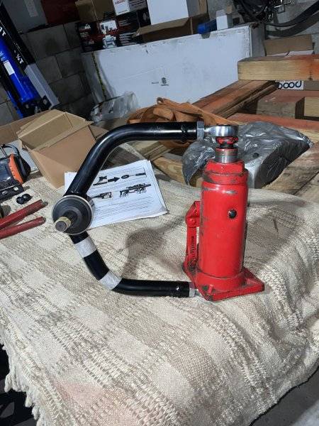

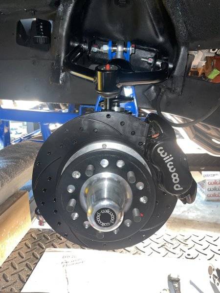

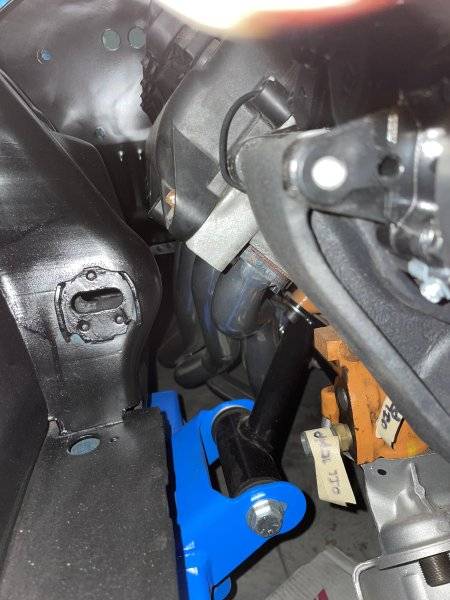

Been working on installing the front QA1 suspension components. Upper control arms are now installed.
A month ago I contacted QA1 about a fitment issue. The spacers used to mount the UCA’s did not fit on the one side, both driver and passenger side. They were about a quarter inch off. I called the tech department and was told to email some pictures. Got no response. Emailed again. No response. I posted on the suspension forum about the issue and how I could fix it. A member told me to just spread them with a pipe and vice. I was skeptical to say the least. I ended up using a small bottle jack for a controlled, calculated spread and it all worked out. They spread quite easily actually. I heard no creaking or cracking noises, so I feel good about the method. Now onward with the rest! Or until another issue is found!

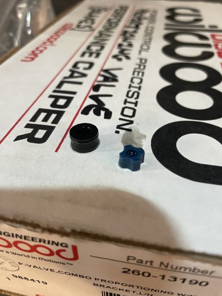

Worked on the front end yesterday. Suspension and brakes are installed. Also removed the clutch delay valve from the fitting that the hydraulic clutch line connects to. Used a dry wall screw to get it out. A little trick learned from a YouTube video.
