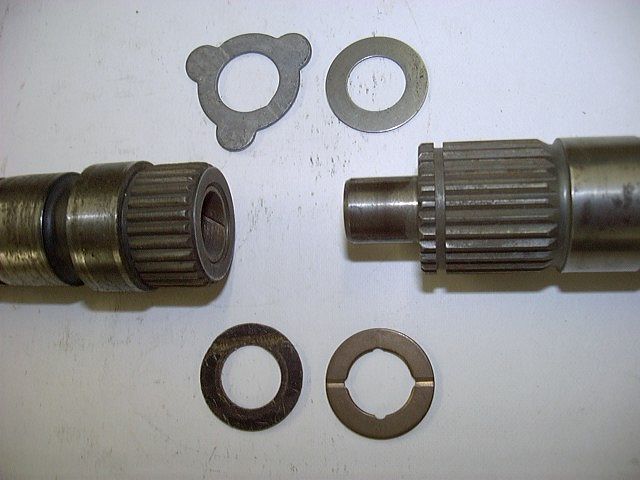

BTW.. the thrust washed between the input/output shaft.. mine is the mickey mouse 3 ear one, is there supposed to be a steel washer between it and the snap ring on the output shaft? It didn't have one when i took it apart.. if so is it anything special or thickness?
These are the 3 different thrust washer set ups. The 3 tab does use a shim. What total endplay did you have? I'll bet it's too much. As I remember 3 tab use was started in 77, the 3 ring shaft was used starting in 78.

End play was .080, I think someone had rebuilt my 62 trans in the mid 70s and then the car got parked, it was like new inside when i got it but it had the 3 tab thrust washer and no shim behind it.. will see if my other trans has the shim and grab it.
