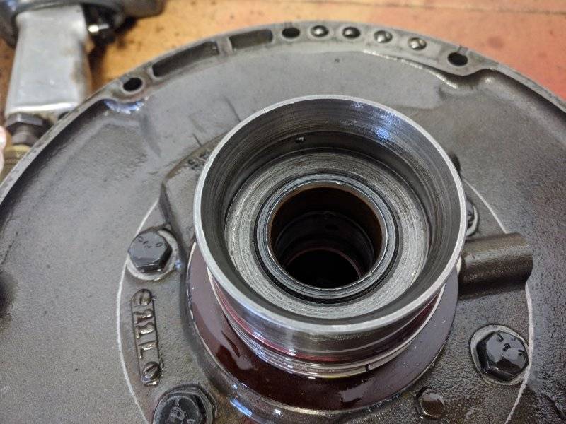

So.. i put it back together last weekend and the endplay was .085, i'm not in a rush to put it back in the car so i figure i'll order a .102 pump washer and a input/output thrust washer shim... Parts show up.. they sent a input/output thrust washer instead of the shim... Just an annoyance as it will now wait another week on a $2 part..

Place hasn't responded back bout the wrong part shipped.. probably gonna put it back together with what i have, should end up around .065 endplay which is in spec but not great, no biggy.
