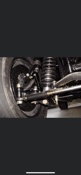

Thanks, but I think my problem is in the suspension .
Yesterday I check my outer tie rods , never Check before because the vibrations since the first test drive there, and there was e erything brand new , the whole front suspension. .
But it looks like minimum the driver side of the outer tie rod are junk

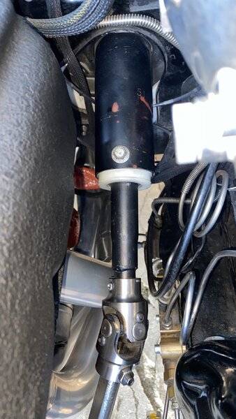

Anyone knows about this screw ? Is one like on 12 and one on 6 a clock , it for holds the white insert inside?
I ask , because I found these 2 screws are little „ lose „
View attachment 944570 Anyone knows about this screw ? Is one like on 12 and one on 6 a clock , it for holds the white insert inside?
That’s the lower steering column bearing. Wouldn’t cause a vibration in my opinion. Just holds the steering shaft centered in the column.

I know only is a Flaming River rack and pinion ( but no part number , looks like FR1520 but not sure , but is a manual rack quick ) and I was thinking it’s a Mustang 2 spindle , but anywhere on my spindle is weld an extension tube for get fit the tie rod .
But I have no idea what company or part number these outer tie rods , and also not sure about the inner tie rods . But normally the inner must be flaming river , because they include with the rack and pinion , right ?
Maybe anyone Else here have a idea ?
Maybe someone here have also the same IFS front suspension ? It’s the 1 generation IFS from Control freak suspensions .

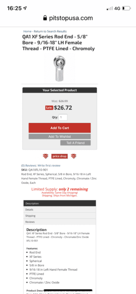

now I figure out the parts have wear , it’s the rack and pinion and the driver side rod end , that’s causes my vibrations in the steering wheel from about 65-85 miles . I also found out what a part number the flaming river rack is ( FR1502-5) and I will order a new flaming river Rack and pinion.
but now I still look for a replacement of this out end rods and maybe new sleeves ... the inner tie rod of the flaming river Rack&pinion have a 9/16-18 thread , means I need end rods with 9/16 male thread and 5/8” bore hole . i only found some from QA1 with 9/16 but female thread and I need male thread .
any idea where I can found some ?
top picture is what I found from QA1 but with female thread , and I need male thread
Below picture is actual rod end with some wear and sleeve
Ah now I found out they sell sleeves from 9/16 to 5/8 and I connect a nice 5/8 thread new end rod on it , perfekt .
I’m right if I recommend a high quality made in USA 3 piece construct with inner Teflon liner the best choice for the rod end ?
