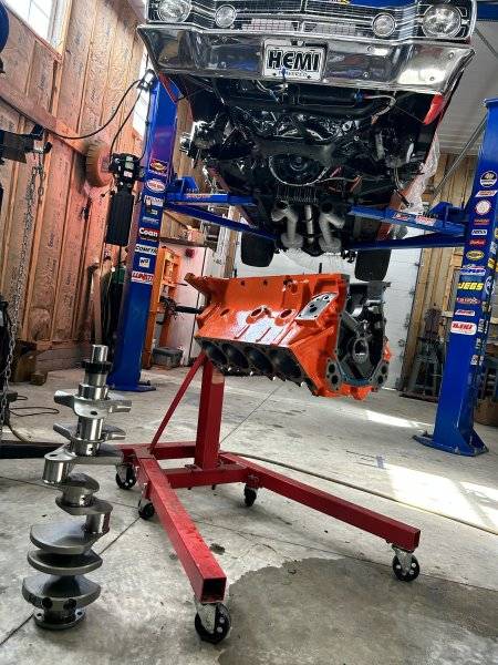

Spent the last 6 years or so collecting parts and building my hemi. As most know, these things aren’t cheap so it takes time. Finally got it all assembled last winter. Ran it on the dyno in January but had some issues with a vacuum leak on the cross ram. Tossed an old unported Barton single plane on and also had issues with sealing that (has some whimpy center section the deflects) and I didn’t have time to let the silicone cure. Anyway, I only got to make 2 real hits on it, one up to 6500 with a 1050. Resealed the ends again and tossed my 1150 on made 1 pull to 7k. Made 818 with zero tuning basically so I was pretty happy (for a pump gas engine). Didn’t really notice anything funky with the engine on the dyno. I dropped it in the car and soon as I rev’d it up I knew something was bad wrong. Doing some quick math I was pretty sure I knew what the problem was. Pulled the engine out this week and tore it down. Sure enough my hunch is correct. Now I bought the whole rotating assembly from a reputable source (which I’m not going to name). Paid extra for the balancing. Now shame on me, I use to do this kind of work for a living. When I pulled the crank out of the box it struck me weird how much weight was removed being a hemi. I just didn’t take the time to really process what I was looking at at the time. Well after running the numbers, it’s 229 grams under balanced on the bob-weight. I feel fortunate we didn’t get to make a bunch of pulls on it now, thinking it may have self destructed as bad as it felt in the car. We will see how they do, I’m not real happy. I’m out time, gaskets, rings, and I feel like the crankshaft is going to be a mess adding all the Mallory into it compounded with all the drilling they have done to it. Guess we will see. Their bobweight Calc was 2199, which is correct if it didn’t have wrist pins, rings, locks, & oil support rails
I have the ability to weigh parts so I did. Surprised it didn’t trash the bearings.

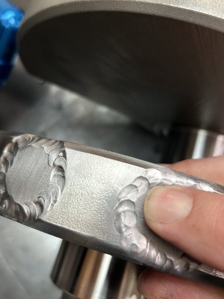

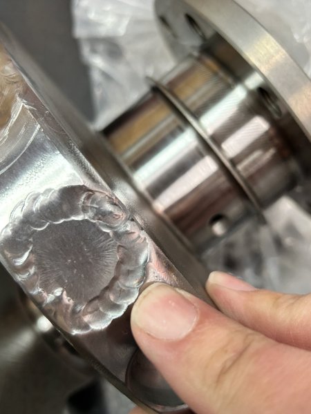

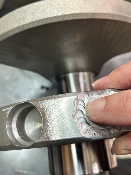

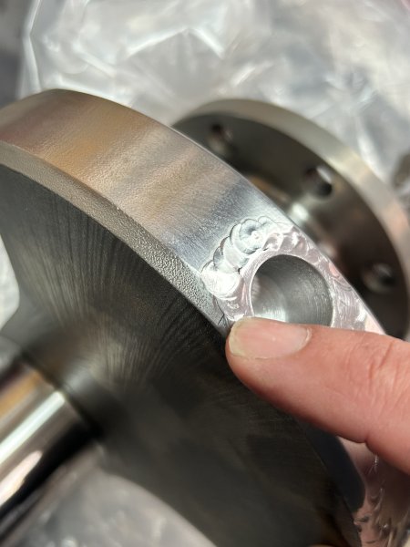

Quick update to my saga. They balanced the crank and sent it back. Needless to say I was less than impressed. No filler rod used to weld weight in. Crack on the counter weight as well as the welds.. not something I’m going to put in my 7k 800hp hemi…
After lots of deliberation I now have a new crank in my possession. Some pics of the hacked re-balance.
Looks like no preheating before tig welding.
View attachment 1566382View attachment 1566383View attachment 1566385View attachment 1566389

I am no fan of weights welded in like that. The centrifugal force throws them out and the do around the same damage to the engine as an artillery round.
Those cracks will often occur when welding dissimilar metals and cooling to quickly and not keeping the inert gas after flow going.
