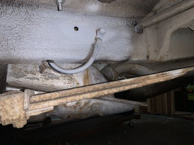

Ground is passing through one of the trunk pan gaskets and mounted to the frame. Pretty sure I sanded down to bare metal before installing but may be worth checking. Don't mind the overspray. Is this not a good location?

You need a #4 or larger ground from the engine to the chassis. Remember when battery is underhood the negative cable goes to the engine. Your starter draws approximately 200 amps. You need a ground cable to flow this many amps. Clean your battery terminals the battery posts.
