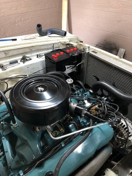

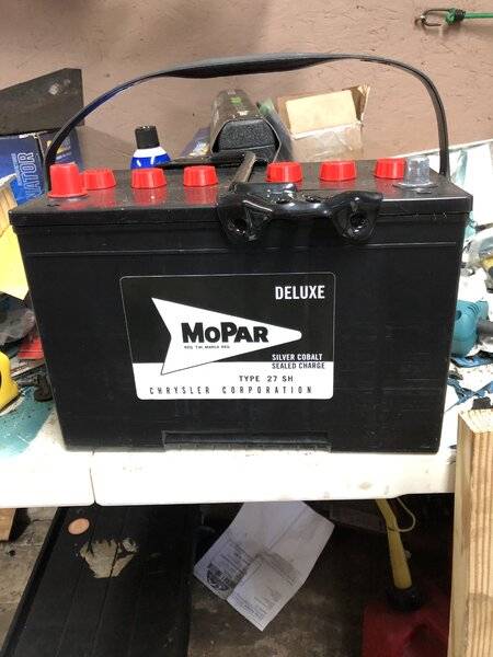

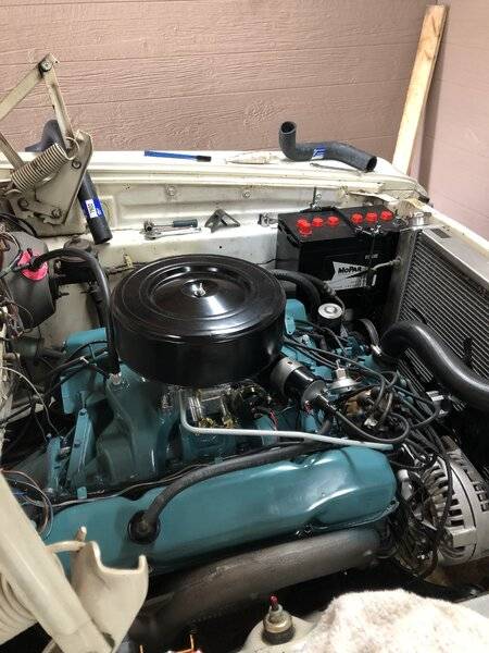

This is my group 27 battery dressed for 1964. The handle has been removed.

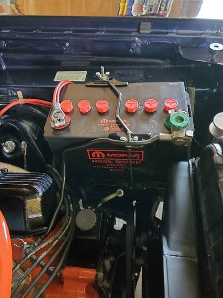

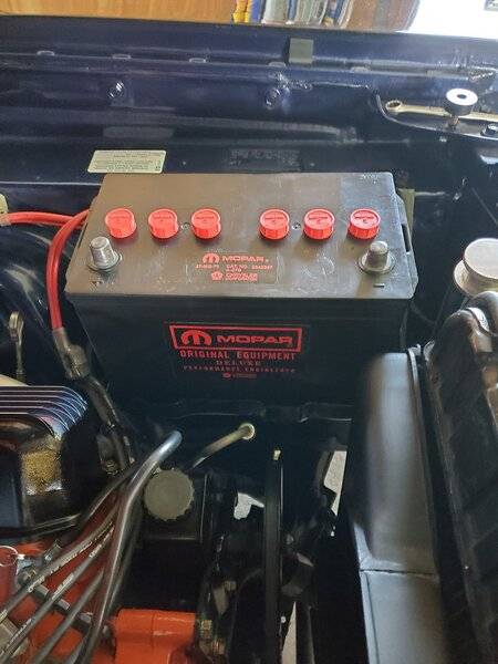

I ordered one of these and it worked out well. I know it's not original and you all know, but how many people can tell this is a Wal Mart battery? I'm not going to tell. Here's a link. They come from Europe so they take a while to get here. Be patient. They have a good selection of push in and glue on caps in 3 colors and different styles. Check your battery first to make sure they will work.
