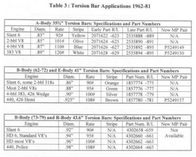

I'm looking for big block 73 and up torsion bars.
Were there different sizes between say a 400 SSP and a 440 RR/GTX?
...or for that matter a 400 Cordoba...
Anyone got part numbers?
Thanks.

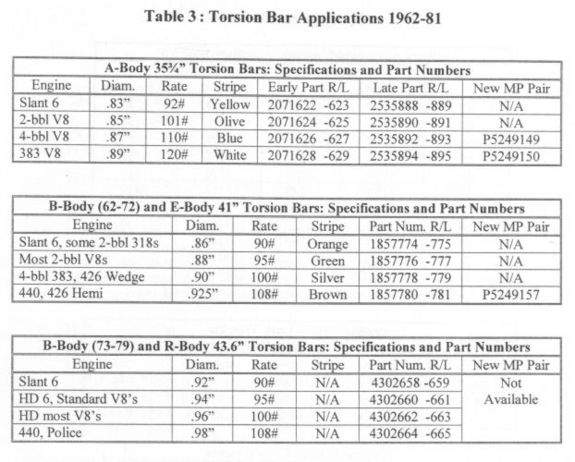

62-72 are 41" long
73-78 are 43.6" long
73-78B:
.92 3402658/659
.94 3402660/661
.96 3402662/663
.98 3402664/665

Read what you posted. :) If you look for T bars for 73-74 cars, those will come up. But you read the description and it states "1962-72 B-Body". It also states "1966-1978 DODGE, 1965-1978 PLYMOUTH", but being as 72 and older bars are shorter than 73 and later bars, this description cannot possibly be accurate. These bars are for the 72 and older cars.
I found a local guy parting a 73 400 Roadrunner.
Which bars would that have come with?
Can we assume...
.92 3402658/659- 6 cyl
.94 3402660/661- small block
.96 3402662/663- big block
.98 3402664/665- HD/cop?
Because Jegs is wrong in their listing. Those are 41" bars and fit 62-72, not thru 78. And why would they fit 65 Plymouth but not Dodge?

once again and we can see it like this, THERE IS NOT E BODY BARS what would fit on 73 and lates cars. E bodies bars are same pre 72 B body bars, period.
Doesn't show post 1972 B body length.
