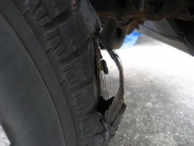

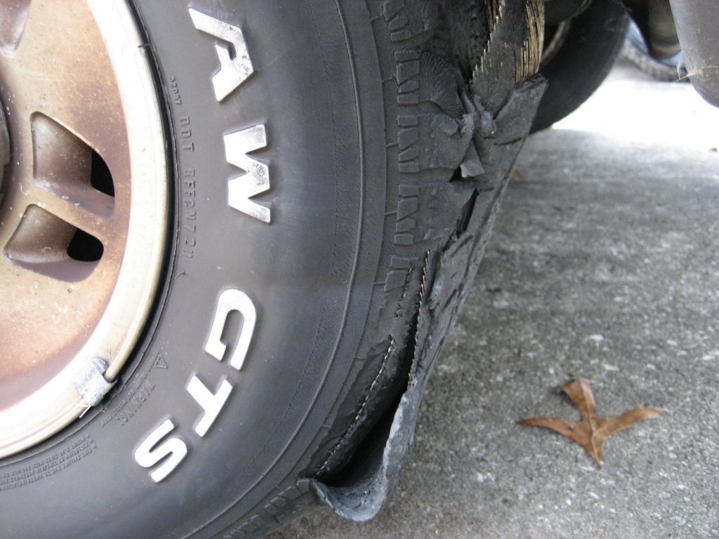

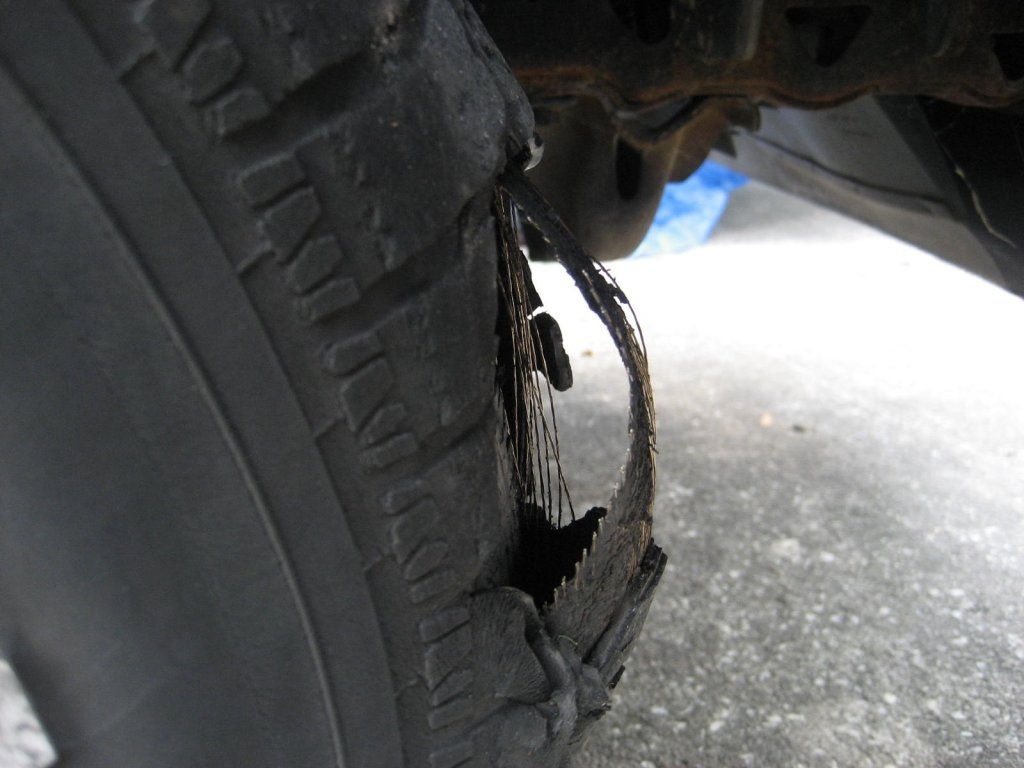

Why quality tires should be used on muscle cars.
Man that sucks atleast you kept it on the road and saved from an even bigger problem ,that shows your a great driver if this happens to a younger person they just let go of there wheel and start taking selfies and post about it .....
AMEN
i've seen it happen 2 times first hand
the first time i got a flat and
threw on old spare and made it about a mile down the road and bye bye expensive fender.
the next time my brother was getting a car that was on a tow dolly
rear tire blew apart and did similar damage to the quarter.
bad tires can do a lot of damage

I want to add my $0.02 regarding old tires. Tires are made to be driven, worn out and then discarded/recycled. Our old muscle cars drive very little so the tires don't LOOK worn, but the tires start failing because the rubber starts breaking down. The Corvette guys are especially nuts - they pay big bucks for 60 year old tires that are time bombs. Those guys barely drive the cars (if at all), but still...
Folks, do yourselves a favor. As someone said in an earlier post: Check the date codes on your tires. If they are more than 10 years old dump them! Is it expensive to buy tires? You bet, but certainly less expensive than major car repairs, or even worse an accident with injuries or death...

Ive been kickin myself around over the fiasco, and thats why I posted it, Hard Lesson to Learn, my car had never been in a body shop other than a repaint, it hurt to see the damage, i was putting money into my Bird Im building neglecting my other car, Not again! Thanks for the comment.
Just for everyone's knowledge what was the date code

For one the OE Gold Mopar and Vette guys with NOS tires they DO NOT drive them on the street. They are backed out of the trailer/transport and babied over to a show spot. Top speed maybe 5mph, lol.....Some even jack the cars up at the show spot and change out the tires to the NOS ones....Most of those cars have about 12-15 grand in just tires alone.....
SO back to the people that drive their cars on the street. I agree 10 years old pitch them away!
