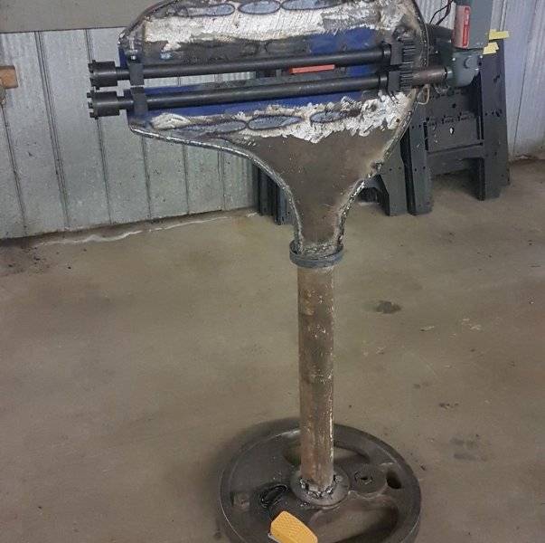

Can't remember where mine came from but having a motorized one is the way to go. Mine is a manual and is great for doing small jobs....
I got mine from Harbour freight.
I beefed it up with some angle iron added a gear motor and made a stand and wired in a foot peddle.
I have not used it much as my model A project got sidetracked due to covid.
I think most bead rollers need to be beefed up to keep the throat from spreading.
I have a harbor freight and had to beef mine up as well otherwise they spread and the Woodward fab piece looks like you will have to do the same
I have not used it much as my model A project got sidetracked due to covid.View attachment 1400723
