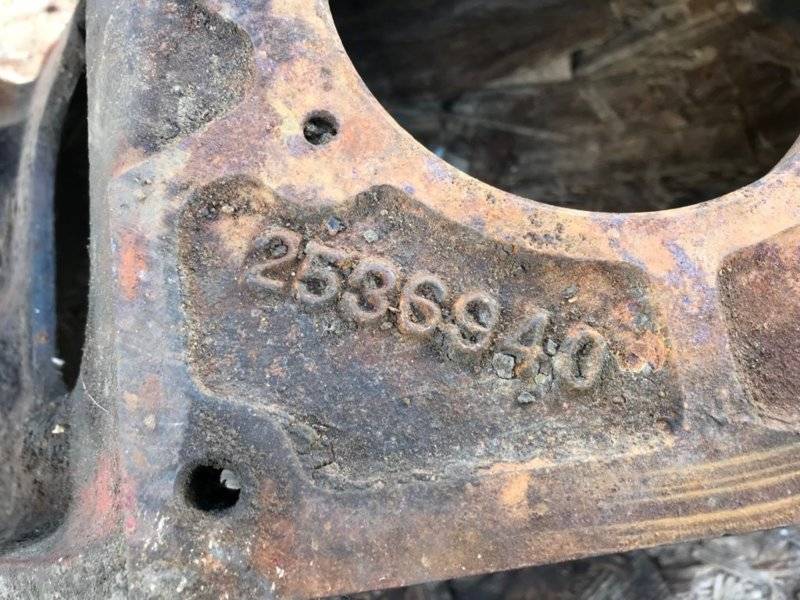

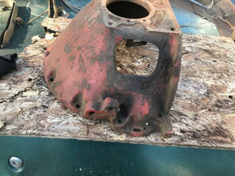

I have a bell that came from a 66 Belvedere with a 318 3 speed trans. Will a 833 4 speed bolt up to it
Yes but the hole in the bell may not fit the bearing retainer.
