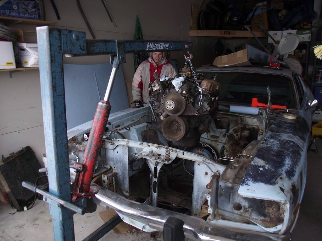

Got the motor pulled, took off one body panel, etc.
Now I REALLY want to get the transmission out, except I can't see how to easily disconnect the shift linkage... any tips? I don't see any screws or bolts anywhere. :-(
Started ripping into the engine... distributor and intake manifold are off, no bent pushrods showing...

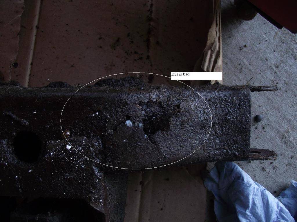

Great project. For the frame rails; you need to remove the rusted portions. They're spot welded to the trunk pans. Try AMD, Goodmark or Sherman's. I don't know if they're avail for your car. Other option is good used rails. If you just want to get by with it for now, Autorust.com may make a piece for your car to go over the frame rail. Either option requires a welder.
There is a lock screw on the swivel, a small , looks like a small bolt head maybe, if you loosin it, you should be able to pull the rod out... There's also a preload spring inside, your rod gos thru.
Thanks for the tips, guys. Yeah, I picked up a welder this week from Northern Tool and Autorust makes the frame rail 'sleeve' dealios that go over the existing rails to repair or reinforce. I know for sure i need the front frame rail on the driver's side... I should do the same on the passenger side while I've got everything apart, anyway.

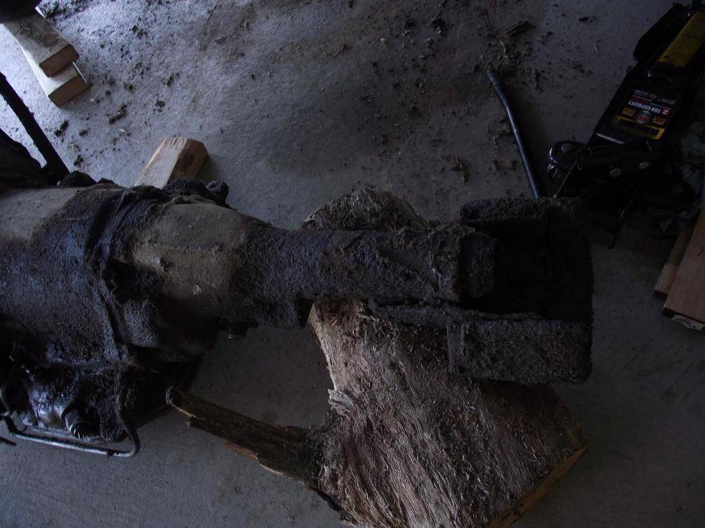

1. Got transmission out. What a joy that was. No transmission jack, blocks of wood and my hydraulic jack. Transmission cross-member rusted through... structurally not sound. :-(
2. Rolled her out of the garage, cleaned up the garage stall, hosed down the interior, scrubbed a lot of crud out of the engine compartment.
3. Cleaned up the transmission. I'm about ready to put it somewhere in 'storage' until it's ready to go back in, I think. I don't think I need to paint it.

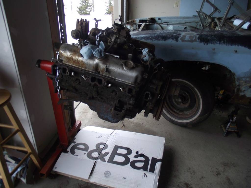

4. Engine broken down to the short block mostly, I can't get the crank bolt off.
I love breaking down the engine, I think I have everything pretty organized still. It looks like some of the rods (I haven't looked at all of them) are stamped with numbers, but they're wrong... like the number one cylinder's rod is stamped with 5.

Filthy transmission...

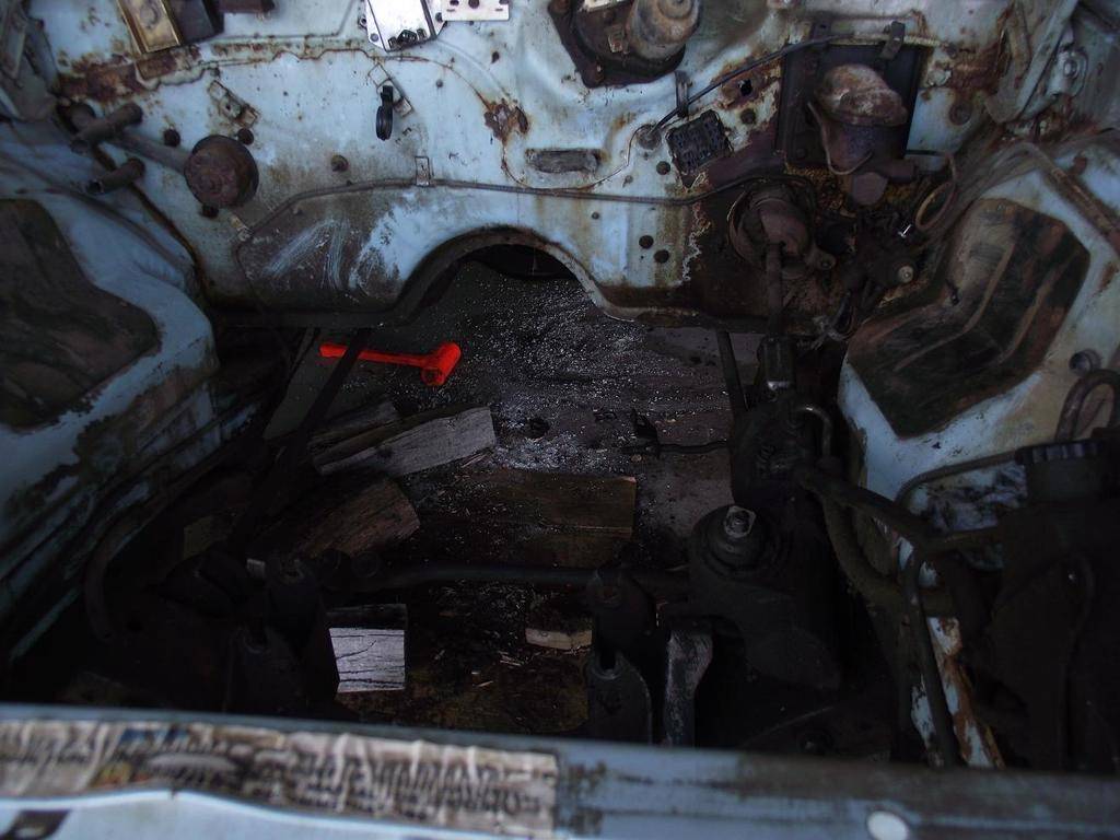

Vacant engine compartment...
