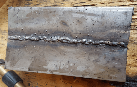

I couldn't find any 4-inch wide 1/8 inch steel for the sides, so I welded two 2-inch pieces together. Had my stepson try it first... he's taking welding in high school. He finally gave up, said my welder is crappy and the stick isn't big enough (kinda personal but whatever). So I tried... got them to hold together with a bunch of crappy little tack welds. I ground it all down and tapped it with a hammer to bend something straight and they just came apart... so I ground all of that crap off and beveled the connecting edges a little and had the most amazing welding experience of my life... I was actually holding an arc long enough to drag it across the seam and held it while pushing the stick closer while it melted off... went through three sticks. It's really ugly but it should hold. (see below) It's also welded on both sides. Now I need to clean it up and fit it to the crossmember and tack it in... and plan my attack on the other side. Also need to figure out what holes are supposed to be in it for snaking lines through... like I think just the brakes (this is the driver's side crossmember).
