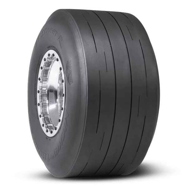

Looking into new tires, currently using MT ET Radio pro 315-60R-15 (29-12.7-15) and im looking at the MT ET Street R Bias Ply street legal Drag tire 31-16.5-15 i'll need to cut the factory wheel well's to get these bad boys in, What tire are you guy Running?
26x10.5x15 m/t et street r bias-ply is what i'm looking at

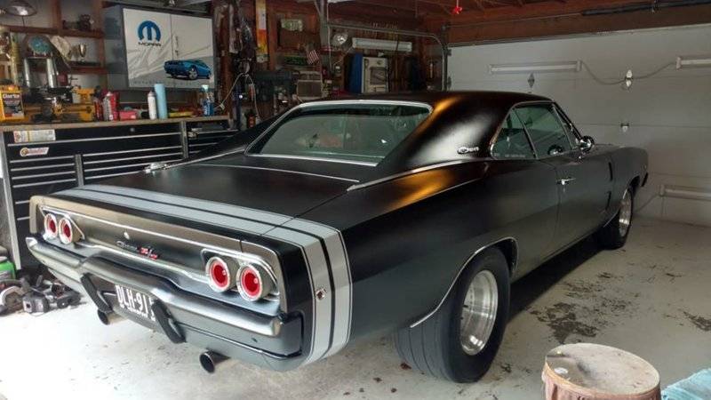

I had the Nittos 325-50-15 555r & they would spin very easy on my Charger, went to the MT ET street R Radial, AWESOME tire, 325-50-15
I had the Nittos 325-50-15 555r & they would spin very easy on my Charger, went to the MT ET street R Radial, AWESOME tire, 325-50-15View attachment 651267

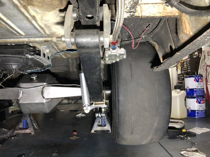

I know of a grudge / street car that has been .096 60 ft & 4.02 in the 1/8 (not a typo) knocking on the door of 200 MPH on a 275-60-15 M/T Radial Pro. They can work when the suspension is dialed in.
Crazy what them guys are running in the 275 class.
Sometimes a prepped track, local No E.T. events.
275 ET Street Pro, Cal-Tracs and split monos.
