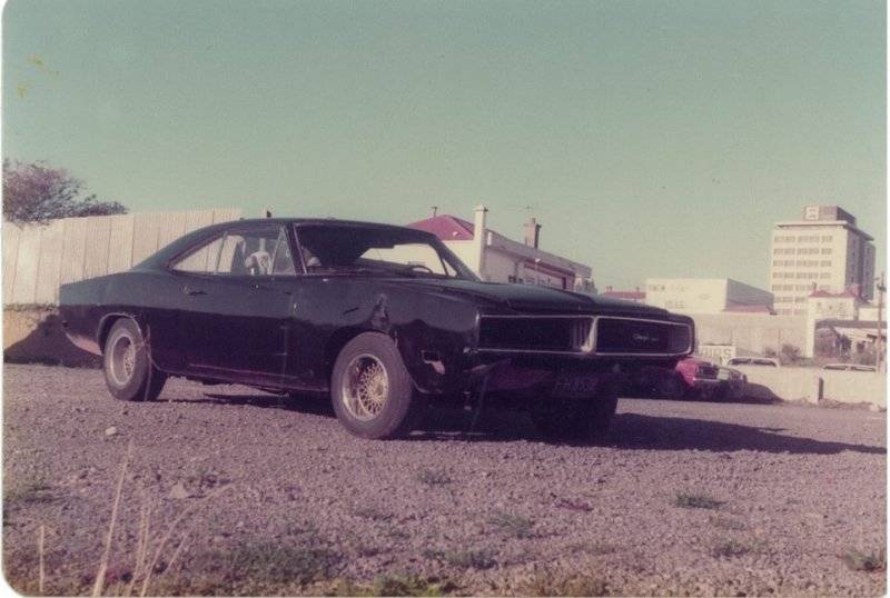

One tool you can use that you probably don't need to buy is a short leaf spring - thet can be used as levers and slapper bars in tight spaces.
I actually found one wedged inside the passenger side front fender of my Charger not long after I bought it. Jammed in so hard I think the previous owner forgot it was there. Explains a lot of the damage when I got the car.

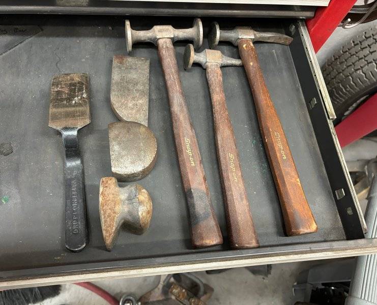

Bought my Snap On 7 piece body kit 32 years ago. These things will out live me.

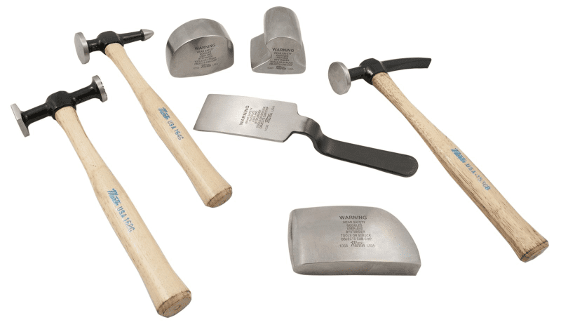

I bought Martin hammers...top quality not too pricey.
