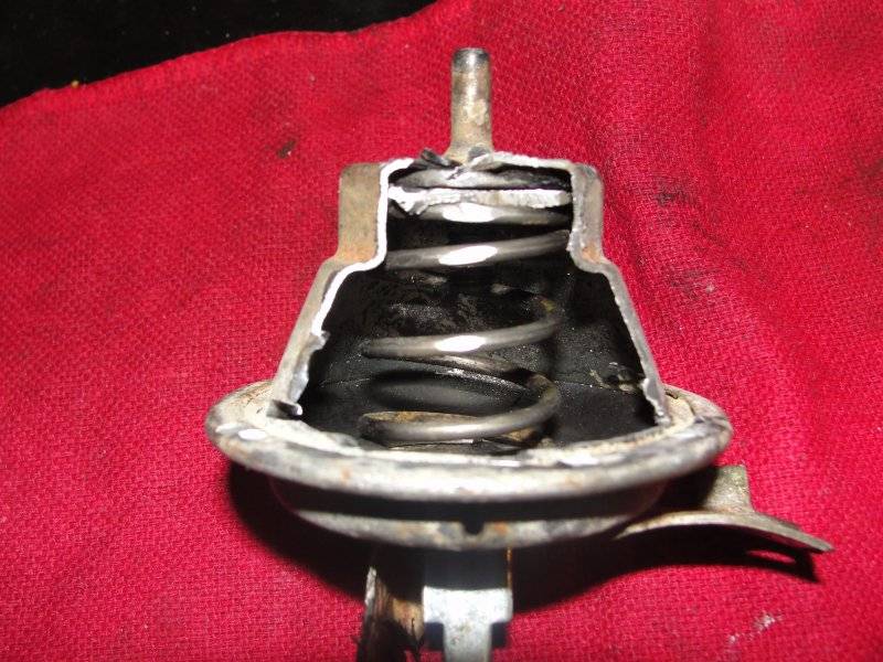

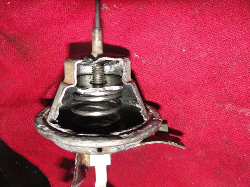

Do you think I can get there with a traditional VA canister? I was reading this thread over at FABO and I can't quite tell if I'll be able to get to 25 deg of VA with the 'normal' vacuum can.
How To Limit and Adjust Chrysler Vacuum Advance Cans

Mopar Vac advance are only rate adjustable not to add or delete timing. Just FYI Adds are misleading and dont tell you that just that they are adjustable. I wish someone made one that is.
