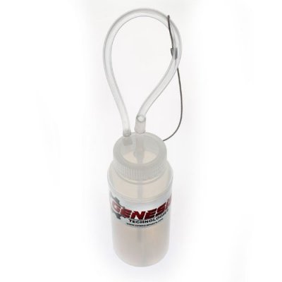

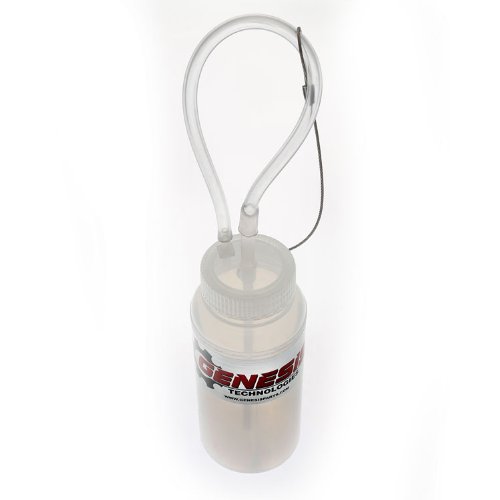

Used the Russell speed bleeders in the past &
when doing full brake replacements, master cylinders, or wheel cylinders or full conversions,
the Motive Products Power Brake Bleeder I paid like $85 & Motive Bleeder Catch Bottles $19 pair,
I got 2 sets, a couple years ago from Summit Racing with my Summit Bucks,
it was really quick & really simple to use, used it on my 02 F350, My 99 Dakota & My 68RR,
I'd give it 5 out of 5 stars...
  • Brakes Motive Product Brake Bleeder Catch Bottles $20.66 pr. mvp-1820_w_ml Summit Racing.jpg
