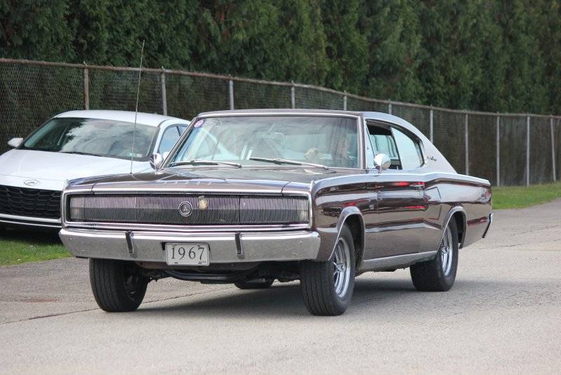

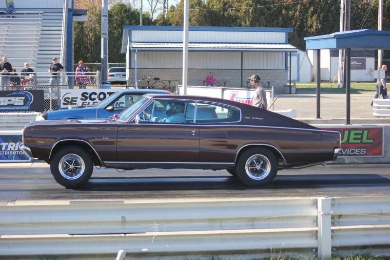

My cousins car, not sure of the sizes off hand. But they can handle a lot.
