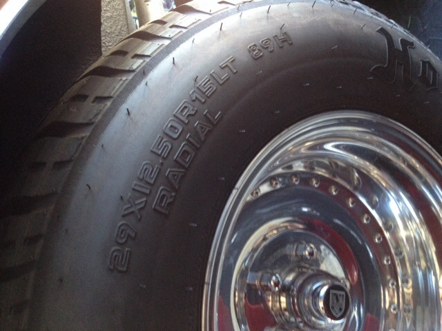

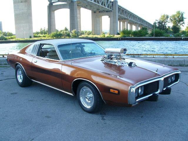

I'm also in the market doing the same research for my 74 Charger.
I know a guy who has 29x12.5 Hoosiers on the back of his 74 Charger.
Slight lift with air shocks but can still rub if maxed out on a bad road.
Not sure what his offset is, the rim was selected by a professional wheel shop.
It is centered as good as it gets between the leaf spring and the fender.
But with this I now know I can safely be next size down from his tire with no issues. I just don't need that much out back anyway - he has a blower.
