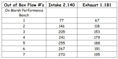

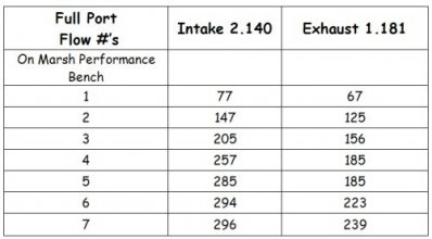

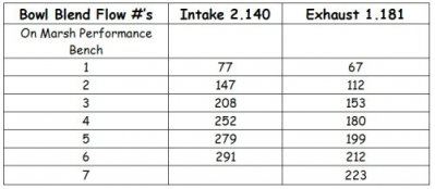

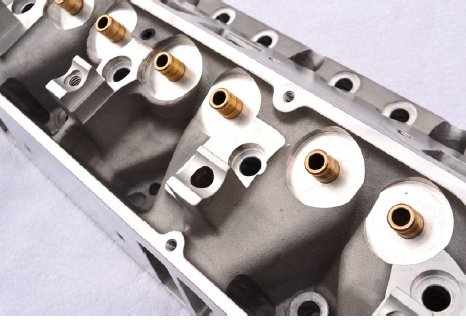

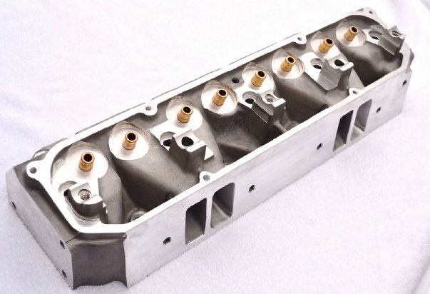

http://mopartsracing.com/parts/Sidewinder.html
Call: 336-283-0800
Back To Front Page - Contact Info - Secure Ordering
Sidewinder Cylinder Heads For Big Block Mopar
Here they are. Introducing the Sidewinder Cylinder Head. Some Features include:
  • Angle plugs
  • 11/32 stem
  • 2.14 intake/ 1.81 exhaust
  • 84 cc chambers
  • 210 cc intake runner volume
  • 70 cc exhaust runner volume
  • Bronze guides
  • Uses all stock type manifolds, valve covers, rockers, headers and gaskets.
We will be offering this head with any “Package” of springs, retainers, and locks that you may require. We do not have a “Standard Package” As we are a Full Service Shop, we are excited to offer this head with virtually ANY spring and retainer combination you might need. Simply provide us with your cam specs and your heads will be built to match.
We can provide any combination of hydraulic flat tappet, mechanical flat tappet, or hydraulic/mechanical roller springs, retainers, and locks. We offer 10degree titanium retainers, viton seals, and high quality valve jobs. The seats and guides are checked and clearance and sized.
These heads are TRULY READY TO RUN HEADS!! They don’t need to go back to the machine shop because they just came from one! Flow Numbers
If you are working with your own engine builder who wants to get the heads ready himself, we are happy to provide all the components you need. We offer products from: Manley, Comp Cams, SI valves, PAC springs, and others. We will provide any of the parts you may require.
We are also proud to offer PORTING SERVICES TO ENHANCE YOUR HEADS! From milling and intake matching, as well as any level of port work.
This is truly a custom package at mail order prices!!
Heads start at $895.00 with valves for a PAIR
Call for pricing on Spring packages to suit your specific application!
Back to Home Page[/paste:font]

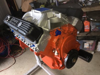

The sidewinder deal above looks pretty good. I run a set of Source Stealths, going on 7 years now and I'd have to say they've been a great value. I changed the springs and retainers, that's all. Planning on a full CNC port job next year, but mine are currently "OTB" on a pump gas 451 and it makes over 500 hp in a very streetable combo that pushes my street car to 11.60's & hopefully faster this year.
I would not hesitate to buy another set from 440Source.

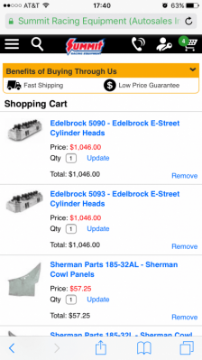

For your price point I'd go with Eddie e streets.

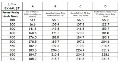

dwayne porter (porter racing heads, 1-800-951-1955) is selling some alum heads for $1500. i think they're the sidewinder type castings (edelbrock clones) but have the valves, springs, etc, hand assembled with flow sheet. if i were to do it again this is what i would do.
