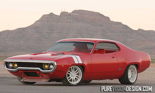

Thanks guys. This is kind of what I had in mind. These have to be 17" or 18" rims right? I don't like them too big. Not into the the ghetto look. But these look great.
Something like this?

Id think 17 in.. on it wouldn't cause any clearance issues, Cant say what was done to that black beauty there but i imagine there every bit 17 inch. Mine is a 73 but i think i could put wagon wheels on it, I run 15 inch and there is more then enough room for more.
The biggest determining factors will be the wheel width and backspacing more than the diameter. To get the "biggest" under the car, you'll need to do some careful measuring (rears full compression/extension; fronts at full compression/extension with wheels at left lock, straight ahead, and right lock.Hope this helps more than confuses.
these are 18". the ones on the black car look like 20" i would say
Just by looking at the photo of the black one tells me those are a staggered 18/20 combo.....
I just think the 71-74 body style looks better with bigger rims because it fills out the wheel wells better. I know a lot of old school guys don't like it but I think it looks better. I am not talking about 20" or 22" ghetto wagon wheels but a good 17"-18" (fronts) to 20" max (rears) look great.
The black car looks like 20s all the way around to me. The red one is prolly running 17s. I like 18s in the back and 17s in front. 20s start to look cartoonish and can be a problem up front. You can stagger them, but 19s are limited and the 2" difference between 20s and 18s is pretty noticeable.

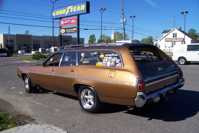

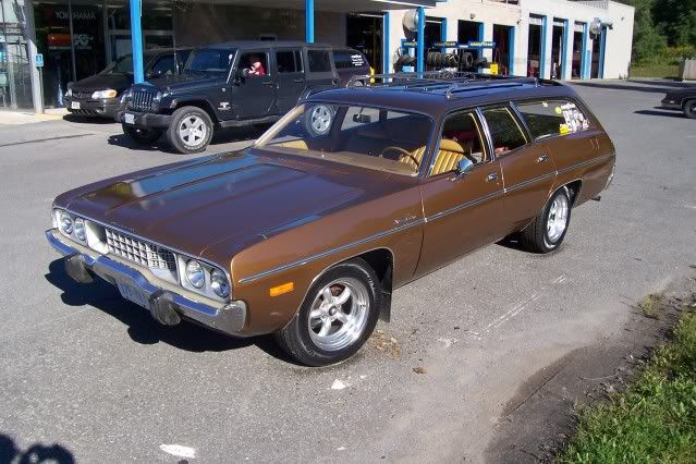

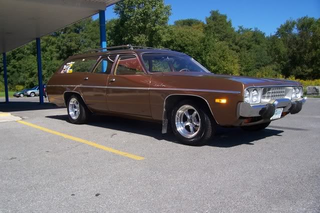

On my 73 Waygun,I went with 2356016 on 16X8 rims with zero offset and 4.50 backspacing.
A good balance of tire sidewall and rim.
Drove a round trip of 450 miles in her yesterday and it is a very smooth ride with improved handling.
